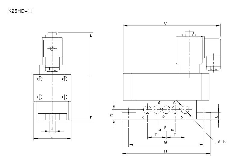

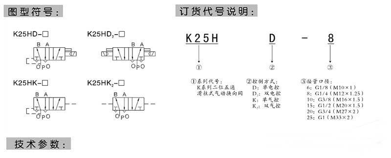

¡ú K25HD2-8|K25HD2-15|K25HK2»¬Öùʽ»»Ïò·§
²úÆ·Ãû³Æ£º
ÐÍ ºÅ£º
0.00
2614
Ïêϸ˵Ã÷£º
»¬Öùʽ»»Ïò·§K25HD
2
-8
»¬Öùʽ»»Ïò·§K25HD
2
-15
ÐͺÅ
½Ó¹ÜÂÝÎÆ K
C
D
E
F
G
H
I
J
L
K25HD-6
G1/8 (M 10X1)
145
14
10
28
112
130
130
9
56
K25HD-8
G1/4 (M 12X1.25)
K25HD-10
G3/8 (M 16X1.5)
163
19
14
38
146
164
165
9
74
K25HD-15
G1/2 (M 20X1.5)
K25HD-20
G3/4 (M 27X2)
241
25
15
60
202
234
210
11
112
K25HD-25
G1 (M 33X2)
ÐͺÅ
½Ó¹ÜÂÝÎÆ K
C1
C2
E
E
F
G
H
I
J
L

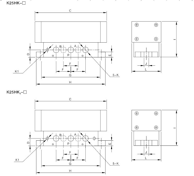

K1
K25HK-6
K25HK
2
-6
G1/8 (M 10X1)
130
130
147
10
28
112
130
130
9
56
M10
K25HK
2
-8
G1/4 (M 12X1.25)
K25HK-10
K25HK
2
-10
G3/8 (M 16X1.5)
161
171
19
14
38
146
164
165
9
74
K25HK-15
K25HK
2
-15
G1/2 (M 20X1.5)
K25HK-20
K25HK
2
-20
G3/4 (M 27X2)
241
230
125
15
60
202
234
210
11
112
K25HK-25
K25HK
2
-25
G1 (M 33X2)
ÐͺÅ
½Ó¹ÜÂÝÎÆ K
C
D
E
F
G
H
I
J
L

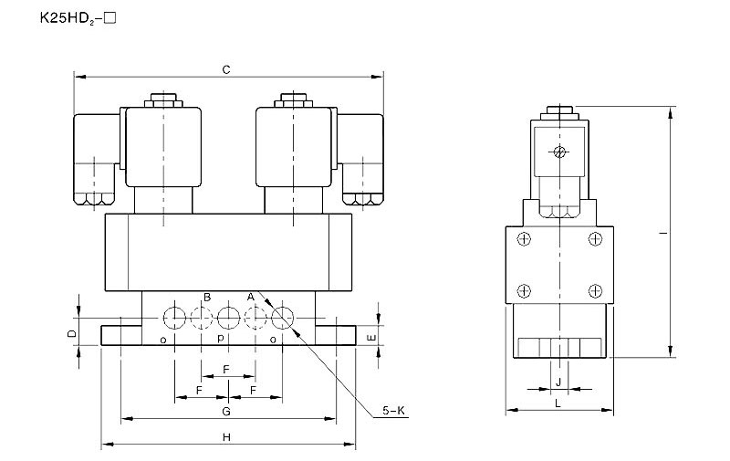

K25HD
2
-6
G1/8 (M 10X1)
160
14
10
28
112
130
130
9
56
K25HD
2
-8
G1/4 (M 12X1.25)
K25HD
2
-10
G3/8 (M 16X1.5)
171
19
14
38
146
164
165
9
74
K25HD
2
-15
G1/2 (M 20X1.5)
K25HD
2
-20
G3/4 (M 27X2)
230
25
15
60
202
234
210
11
112
K25HD
2
-25
G1 (M 33X2)
ÐÍ ºÅ
K25HD-6
K25HD
2
-6
K25HK-6
K25HK
2
-6
K25HD-8
K25HD
2
-8
K25HK-8
K25HK
2
-8
K25HD-10
K25HD
2
-10
K25HK-10
K25HK
2
-10
K25HD-15
K25HD
2
-15
K25HK-15
K25HK
2
-15
K25HD-20
K25HD
2
-20
K25HK-20
K25HK
2
-20
K25HD-25
K25HD
2
-25
K25HK-25
K25HK
2
-25
¹¤×÷ѹÁ¦ (MPa)
0.15~0.8
½éÖÊÎÂ¶È (¡ãC)
0~55
»·¾³ÎÂ¶È (¡ãC)
-5~50
µçÔ´µçѹ (V)
AC: 220, 110, 36, DC: 24, 12 (Æø¿ØÎÞ±¾Ïî²ÎÊý)
ÊÙÃü (Íò´Î)
>=150
¹¤×÷½éÖÊ
¾¾»»¯£¬º¬ÓÐÈó»¬Ó͵ÄѹËõ¿ÕÆø
¹«³ÆÍ¨¾¶ (mm)
6
8
10
15
20
25
Á÷ͨÄÜÁ¦SÖµ (mm
2
10
20
40
60
120
190
»»Ïòʱ¼ä (s)
=<0.06
=<0.08
=<0.12
»»ÏòƵÂÊ (s)
>=10
>=8
>=5
й©Á¿ (cm
2
/min)
=<10
=<25
=<50
