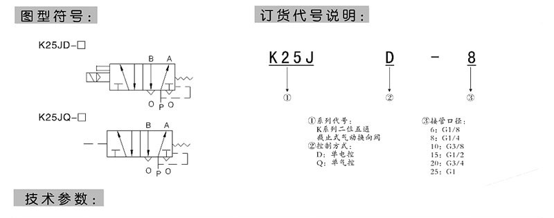

Ïêϸ˵Ã÷£º
K25JD-8
ÐÍ ºÅ
K25JD-6
K25JQ-6
K25JD-8
K25JQ-8
K25JD-10
K25JQ-10
K25JD-15
K25JQ-15
K25JD-20
K25JQ-20
K25JD-25
K25JQ-25

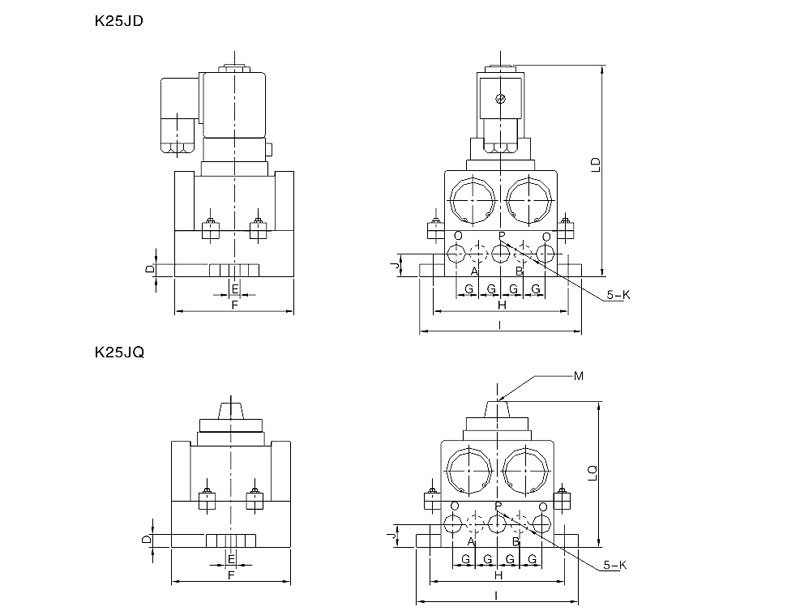

ÐͺÅ
½Ó¹ÜÂÝÎÆ K
D
E
F
G
H
I
J
LD
LQ
M
K25JD-6
K25JQ-6
G1/8 (M10X1)
8
7
75
14
85
102
14
136
90
G1/8
K25JD-8
K25JQ-8
G1/4 (M12X1.25)
6
90
K25JD-10
K25JQ-10
G3/8 (M16X1.5)
12
9
108
19
116
138
19
151
100
K25JD-15
K25JQ-15
G1/2 (M20X1.5)
10
120
K25JD-20
K25JQ-20
G3/4 (M27X2)
12
13
160
30
180
208
30
220
150
K25JD-25
K25JQ-25
G1 (M33X2)
