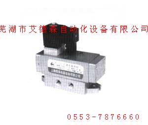

²úÆ·Ãû³Æ£º µç¿Ø»»Ïò·§K25D-6.K25D-8.K25D-10.K25D-15
ÐÍ ºÅ£º
Ïêϸ˵Ã÷£º
£±¡¢½á¹¹¼òµ¥£¬Ó¦Óù㷺¡£
£²¡¢¹Ü½Ó¡¢°å½Ó£¬°²×°·½±ã¡£
£³¡¢Æ·ÖÖ¡¢¹æ¸ñÆëÈ«£¬ÈÎÒâÑ¡Ôñ¡£

ËÄ¡¢¼¼Êõ²ÎÊý
¹«³ÆÍ¨¾¶mm 6(8) 10(15) 20(25)
ÓÐЧ½ØÃæ»ýSÖµmm² 10(20) 40(60) 120(190)
»»Ïòʱ¼äS 0.06 0.08 0.12
¹¤×÷ѹÁ¦·¶Î§ 0.2¡«0.8MPa
й©Á¿ 50Nml/min 100Nml/min 200Nml/min
¹¤×÷ÎÂ¶È 5¡«60¡ãC
×î¸ßÔÊÐíÇл»ÆµÂÊ 8HZ 6HZ 4HZ
¹¤×÷µçѹ AC:220V,36V DC:24V,12V
