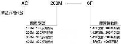

¡¡¡¡XC4V(A)ϵÁÐÆø¶¯³É×é»»Ïò·§ÊÇÓÉÁ½¸öÒÔÉϵĵ¥£¨Ë«£©µç´Å»»Ïò·§»òµ¥£¨Ë«£©Æø¿Ø»»Ïò·§Í³¼¯×°ÓÚ·§°åÉÏ£¬Í³Ò»½øÆøÓëÅÅÆø¡£½á¹¹½ô´Õ£¬°²×°¼ò±ã¡£
XC4V(A)ϵÁÐÆø¶¯³É×é»»Ïò·§·§°åÐÍÆ×
