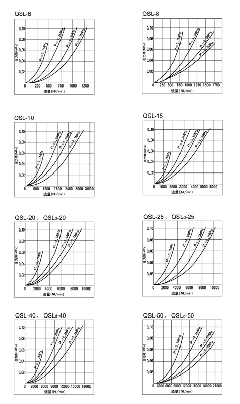

*Á÷Á¿ÌØÕ÷ÇúÏß

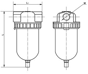

Îå¡¢ÍâÐΰ²×°³ß´ç
¹«³ÆÍ¨¾¶
M
L
L1
6
G1/8"
M10¡Á1
173
80
8
G1/4"
M12¡Á1.25
M14¡Á1.5
173
80
10
G3/8"
M16¡Á1.5
M18¡Á1.5
173
80
15
G1/2"
M20¡Á1.5
M22¡Á1.5
173
80
20
G3/4"
M27¡Á2
219
115
25
G1"
M33¡Á2
219
115
40
G11/2"
M48¡Á2
280
132
G2"
M60¡Á2
280
132
