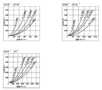

*»¹ÓУ±¡«£µ¦Ì£í£»£µ¡«£±£°¦Ì£í£»£±£°¡«£²£µ¦Ì£í£»£²£µ¡«£µ£°¦Ì£í¿É¹©Ñ¡Ôñ¡£
*¹ýÂËÆ÷µÄÅä¹ÜÖ±¾¶Ð¡Ò»ºÅʱ£¬×î´óÁ÷Á¿Ô¼¼õÉÙ£±£°£¥£»ÂËоֱ¾¶Ð¡Ò»ºÅʱ£¬×î´óÁ÷Á¿Ô¼¼õÉÙ£·£¥¡£
Á÷Á¿ÌØÕ÷ÇúÏߣº

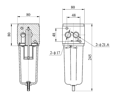

Îå¡¢ÍâÐΰ²×°³ß´ç£º
394ϵÁÐ 394-B20
ÐͺŠW A B C E F G J K L ÖØÁ¿kg
394£­6 G1/8" 40 135 40 20 20 160 20 20 4.8 0.31
394£­8 G1/4" 40 135 40 20 20 160 20 20 4.8 0.3
394£­10 G3/8" 60 187 60 30 30 227 35 35 5.7 0.96
394£­15 G1/2" 60 187 60 30 30 227 35 35 5.7 0.94
394£­20 G3/4" 80 240 80 40 40 290 48 48 7 1.05
394£­25 G1" 80 240 80 40 40 290 48 48 7 1
