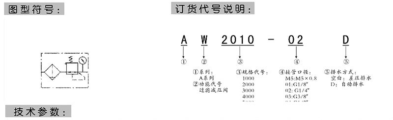

·§ ÐÍ
´øÒçÁ÷ÐÍ

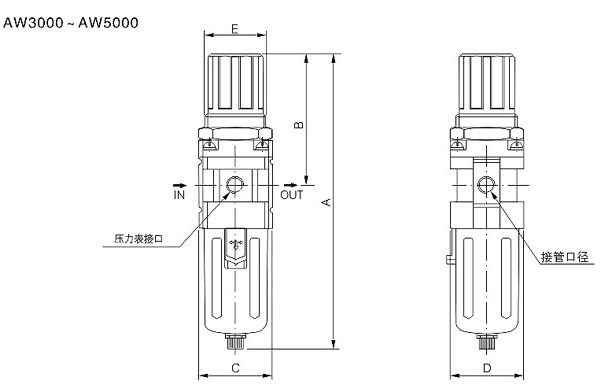

ÐÍ ºÅ
½Ó¹Ü¿Ú¾¶
A
B
C
D
E
AWW1000
M5
109.5
50.5
25
28
28
AW2000
1/8-1/4
164.5
78
40
40
34
AW3000
1/4-3/8
211
92.5
53
53
40
AW4000
3/8-1/2
262
112
70
70
54
AW4000-06
3/4
267
114
70
70
54
AW5000
3/4-1
338
116
90
90
54
µ÷ѹ¹ýÂËÆ÷AW2000-01¡¢£¨SMC»ùÐÍ£©µ÷ѹ¹ýÂËÆ÷AW2000-02¡¢£¨SMC»ùÐÍ£©µ÷ѹ¹ýÂËÆ÷AW3000-02¡¢£¨SMC»ùÐÍ£©µ÷ѹ¹ýÂËÆ÷AW3000-03¡¢£¨SMC»ùÐÍ£©µ÷ѹ¹ýÂËÆ÷AW4000-03¡¢£¨SMC»ùÐÍ£©µ÷ѹ¹ýÂËÆ÷AW4000-04¡¢£¨SMC»ùÐÍ£©µ÷ѹ¹ýÂËÆ÷AW4000-06¡¢£¨SMC»ùÐÍ£©µ÷ѹ¹ýÂËÆ÷AW5000-06¡¢£¨SMC»ùÐÍ£©µ÷ѹ¹ýÂËÆ÷AW5000-10¡¢£¨SMC»ùÐÍ£©×Ô¶¯ÅÅË®Æ÷AD402
