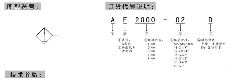

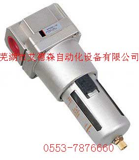

²úÆ·Ãû³Æ£º
AF2000-02,AF3000-03,AF4000-04,AF5000-10¿ÕÆø¹ýÂËÆ÷
ÐÍ ºÅ£º

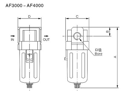

ÐÍ ºÅ |
½Ó¹Ü¿Ú¾¶ |
A |
B |
C |
D |
AF1000 |
M5 |
66 |
7 |
25 |
AF2000 |
1/8-1/4 |
97.5 |
11 |
40 |
40 |
AF3000 |
1/4-3/8 |
132.5 |
14 |
53 |
53 |
AF4000 |
3/8-1/2 |
168.5 |
18 |
70 |
70 |
AF4000-06 |
3/4 |
172.5 |
20 |
70 |
70 |
AF5000 |
3/4-1 |
247.5 |
24 |
90 |
90 |
