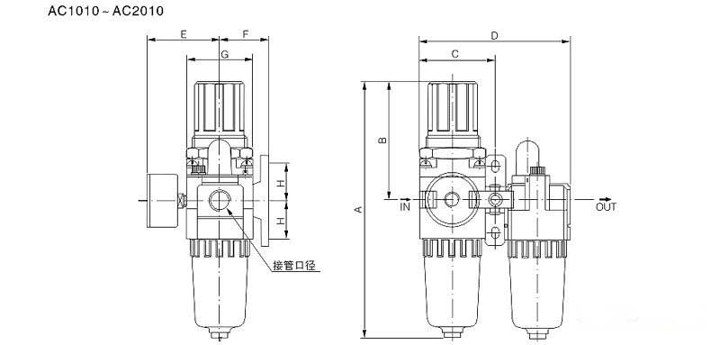

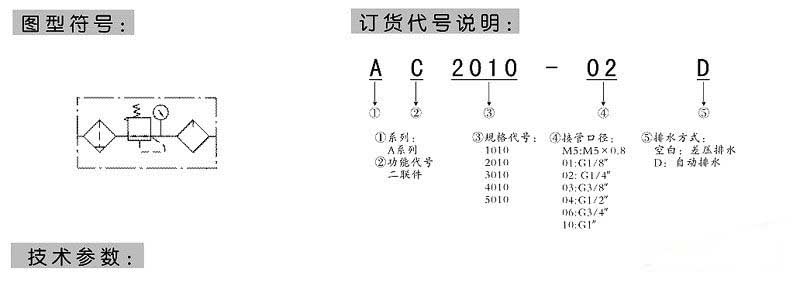

ÐÍ ºÅ
AC1010-M5
AC2010-01
AC2010-02
AC3010-02
AC3010-03
AC4010-03
AC4010-04
AC4010-06
AC5010-06
AC5010-10
¶î¶¨ÈÝÁ¿
90
500
500
1700
1700
3000
3000
3000
4000
4000
½Ó¹Ü¿Ú¾¶
M5
1/8
1/4
1/4
3/8
3/8
1/2
3/4
3/4
1
¹ýÂ˾«¶È
25 µm
×î¸ßʹÓÃѹÁ¦
1.0MPa
±£Ö¤ÄÍѹÁ¦
1.5MPa
ʹÓÃζȷ¶Î§
5~60¡ãC
µ÷ѹ·¶Î§
0.05~0.85MPa
½¨ÒéÓÃÓÍ
ISO VG 32
ÈÝÆ÷²ÄÁÏ
¾Û̼ËáÖ¬
·À»¤ÕÖ
ÎÞ
ÓÐ
·ÅË®Æ÷¹¦ÄÜ
²îѹ·ÅË®
²îѹ·ÅË®¡¢ ×Ô¶¯·ÀË®
·§ ÐÍ
´øÒçÁ÷ÐÍ
×é¼þ
¹ýÂ˵÷ѹ·§
AW1000-M5
AW2000-01
AW2000-02
AW3000-02
AW3000-03
AW4000-03
AW4000-04
AW4000-06
AW5000-06
AW5000-10
ÓÍÎíÆ÷
AL1000-M5
AL2000-01
AL2000-02
AL3000-02
AL3000-03
AL4000-03
AL4000-04
AL4000-06
AL5000-06
AL5000-10
ÐÍ ºÅ
½Ó¹Ü¿Ú¾¶
A
B
C
D
E
F
G
H
AC1010
M5
109.5
50.5
29
58
26
25
25
20
AC2010
1/8-1/4
164.5
78
45
90
56.8
30
40
24
AC3010
1/4-3/8
211
92.5
58.5
117
60.8
41
53
35
AC4010
3/8-1/2
262
112
77
154
70.5
41
70
40
AC4010-06
3/4
267
114
82
164
70.5
70
40
AC5010
3/4-1
338
116
97.5
195
75.5
69.8
90
