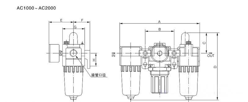

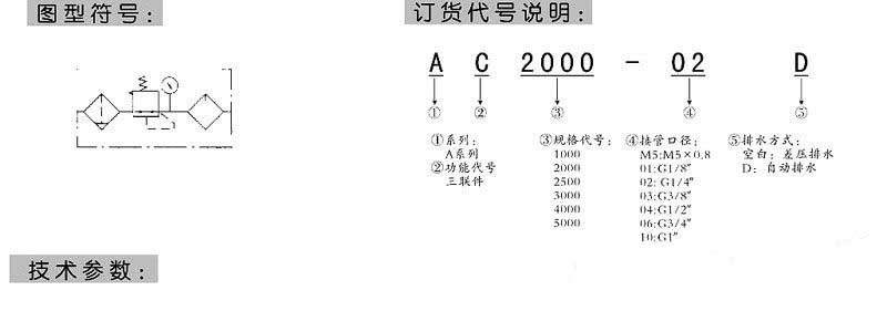

ÐÍ ºÅ
AC1000-M5
AC2000-01
AC2000-02
AC2500-02
AC2500-03
AC3000-02
AC3000-03
AC4000-03
AC4000-04
AC4000-06
AC5000-06
AC5000-10
¶î¶¨ÈÝÁ¿
90
500
500
1500
1500
2000
2000
4000
4000
4500
5000
5000
½Ó¹Ü¿Ú¾¶
M5
1/8
1/4
1/4
3/8
1/4
3/8
3/8
1/2
3/4
3/4
1
¹ýÂ˾«¶È
25 µm
×î¸ßʹÓÃѹÁ¦
1.0MPa
±£Ö¤ÄÍѹÁ¦
1.5MPa
ʹÓÃζȷ¶Î§
5~60¡ãC
µ÷ѹ·¶Î§
0.05~0.85MPa
½¨ÒéÓÃÓÍ
ISO VG 32
ÈÝÆ÷²ÄÁÏ
¾Û̼ËáÖ¬
·À»¤ÕÖ
ÎÞ
ÓÐ
·ÅË®Æ÷¹¦ÄÜ
²îѹ·ÅË®
²îѹ·ÅË®¡¢ ×Ô¶¯·ÀË®
·§ ÐÍ
´øÒçÁ÷ÐÍ
×é¼þ
¹ýÂËÆ÷
AF1000-M5
AF2000-01
AF2000-02
AF3000-02
AF3000-02
AF3000-02
AF3000-03
AF4000-03
JAF4000-04
AF4000-06
AF5000-06
AF5000-10
µ÷ѹ·§
AR1000-M5
AR2000-01
AR2000-02
AF2500-02
AF2500-02
AR3000-02
AR3000-03
AR4000-03
JAR4000-04
AR4000-06
AR5000-06
AR5000-10
ÓÍÎíÆ÷
AL1000-M5
AL2000-01
AL2000-02
AL3000-02
AL3000-02
AL3000-02
AL3000-03
AL4000-03
JAL4000-04
AL4000-06
AL5000-06
AL5000-10
ÐÍ ºÅ
½Ó¹Ü¿Ú¾¶
A
B
C
D
E
F
G
H
AC1000
M5
91
33
25.5
84.5
26
25
25
20
AC2000
1/8-1/4
140
38
125
56.8
30
40
24
AC2500
1/4-3/8
181
64
38
156.5
60.8
41
53
35
AC3000
1/4-3/8
181
64
38
156.5
60.8
41
53
35
AC4000
3/8-1/2
238
84
41
191.5
65.5
70
40
AC4000-06
3/4
253
89
41
193
69.5
70
40
AC5000
3/4-1
300
105
38
271.5
75.5
69.8
90
