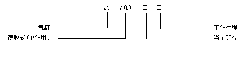

ÌØµã£ºQGV£¨D£©±¡Ä¤Æø¸×
1¡¢±¾¹«Ë¾´´Ð²úÆ·£¬ÊÊÓ¦¶ÌÐг̳¡ºÏʹÓã»
2¡¢ÃÜ·âÐԺ㬲»Ò×Â©Æø£»
3¡¢½á¹¹¼òµ¥¡¢½ô´Õ£¬Ìå»ýС£¬ÖØÁ¿Ç᣻
4¡¢ÎÞÄ¥Ëð¼þ£¬Î¬»¤·½±ã¡£
Æø¸×ÐͺţºQGV£¨D£©±¡Ä¤Æø¸×
µ±Á¿¸×¾¶£¨mm£©
140
160
»îÈû¸ËÖ±¾¶£¨mm£©
32
32
¹¤×÷Ðг̣¨mm£©
45
¹¤×÷ѹÁ¦£¨MPa£©
0.1¡«0.63
ÄÍѹÁ¦£¨MPa£©
0.954
ʹÓÃζȷ¶Î§£¨¡æ£©
- 25 ¡« + 80 (µ«ÔÚ²»¶³½áÌõ¼þÏÂ)
¹¤×÷½éÖÊ
¾­¹ý¾»»¯²¢º¬ÓÐÓÍÎíµÄѹËõ¿ÕÆø
Æø¸×ÍÆÁ¦£¨N£©
£¨P=0.5MPa£©
ÐÐ³ÌÆðµã
7716
9810
ÐгÌÖÕµã
5648
7198
µ¯»É³õ·´Á¦£¨N£©
84.4
120
µ¯»ÉÖÕ·´Á¦£¨N£©
180
230
