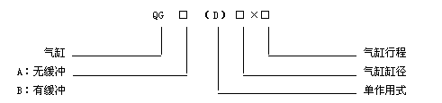

气缸型号:QGA(D)和QGB(D)单作用气缸
