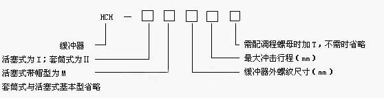

²úÆ·Ðͺţº
HCH-IM1007   HCH-IM1412    HCH-IM2725    HCH-II2508
HCH-I1007    HCH-I2015     HCH-I2725     HCH-II3009
HCH-I1412    HCH-IM2015    HCH-II2007    HCH-II3213
