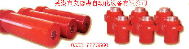

ľҵѹ»úÖùÈûÓÍ¸× YZGϵÁÐ
¡¡¡¡YZGÐÍΪľҵ»úеѹ»úרÓÃÖùÈûÓ͸ף¬ÊÊÓÃÓÚÈý¼Ð°å¡¢ÅÙ»¨°å¡¢ÖÐÏ˰塢¸´ºÏµØ°å¡¢Öñ½º°å¡¢Ä¾°å³ÉÐεÈѹ»úÉÏʹÓ㬹¤×÷ѹÁ¦Ò»°ãΪ26MPa,ÖùÈûÖ±¾¶63-520mm,ÓÐЧÐгÌ0-5000m
