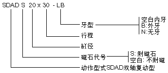

ÐͺÅ˵Ã÷

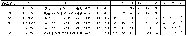

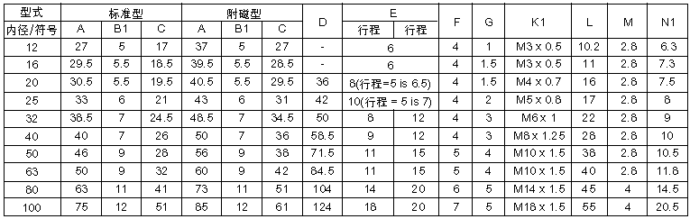

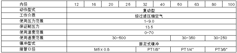

¼¼Êõ²ÎÊý
ʾÀý
Óû¶©¹º¸×¾¶Îª20mm£¬ÐгÌΪ30mm£¬¸½´Åʯ£¬»îÈû¸ËÑÀÐÍΪÄÚÑÀÐÍʽµÄË«ÖḴ¶¯Ðͳ¬±¡Æø¸×£¬ÆäÕýÈ·µÄ¶©¹ºÂëΪ:SDADS-20 x 30¡£
Óû¶©¹º¸×¾¶Îª
63mm£¬ÐгÌΪ30mm£¬²»¸½´Åʯ£¬»îÈû¸ËÑÀÐÍΪÄÚÑÀÐÍʽµÄË«ÖḴ¶¯Ðͳ¬±¡Æø¸×£¬ÆäÕýÈ·µÄ¶©¹ºÂëΪ:SDAD-60 x 30¡£

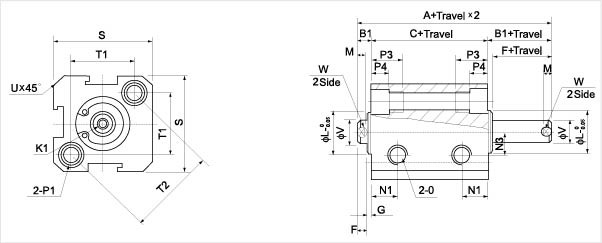

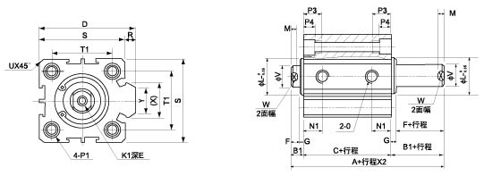

SDAD SDADS ³¬±¡Æø¸×»ù±¾Ðͼ°³ß´ç
