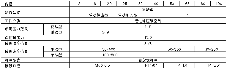

ÐͺÅ˵Ã÷
¼¼Êõ²ÎÊý

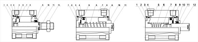

ÄÚ²¿½á¹¹
ʾÀý

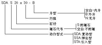

1.Óû¶©¹º¸×Ϊ50mm,ÐгÌΪ30mm,¸½´Åʯ£¬»îÈû¸ËÑÀÐÍʽµÄ¸´¶¯Ðͳ¬±¡Æø¸×£¬Æä¶©¹ºÂë´úºÅ£ºSDAS-50X30-B.
2.Óû¶©¹º¸×¾¶Îª20mm,ÐгÌΪ25mm,²»¸½´Åʯ,»îÈû¸ËÑÀÐÍΪÄÚÑÀÐÍʽµÄµ¥¶¯ÒýÈëÐͳ¬±¡Æø¸×,Æä¶©¹ºÂë´úºÅ:STA-20X25.

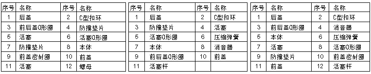

Ö÷ÒªÁã¼þ²ÄÖÊ

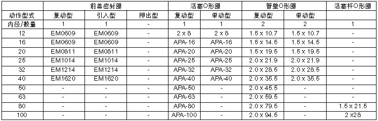

O ÐÎȦһÀÀ±í

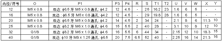

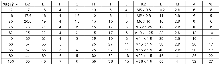

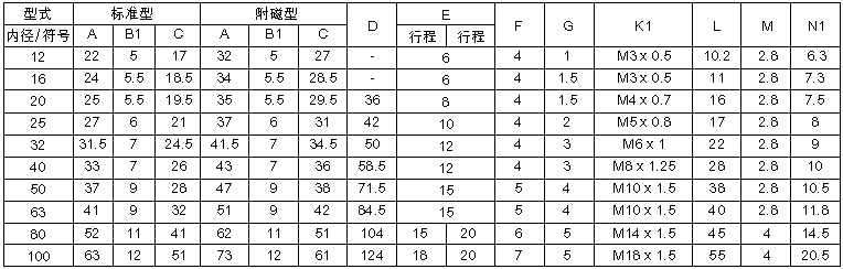

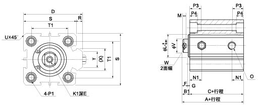

SDA SDAS ³¬±¡Æø¸×»ù±¾Ðͼ°³ß´ç

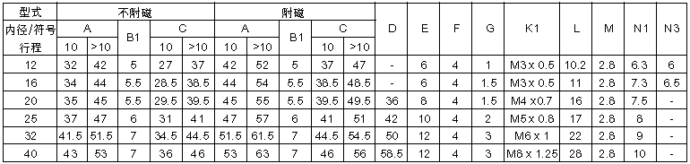

SSA SSAS ³¬±¡Æø¸×»ù±¾Ðͼ°³ß´ç

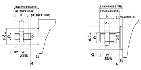

STA STAS ³¬±¡Æø¸×»ù±¾Ðͼ°³ß´ç
