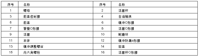

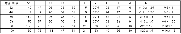

SUϵÁбê×¼Æø¸×

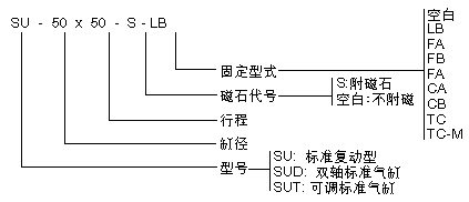

ÐͺÅ˵Ã÷

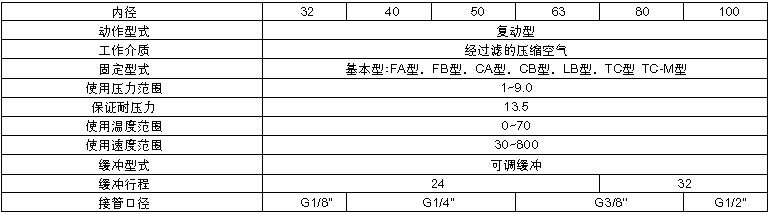

¼¼Êõ²ÎÊý

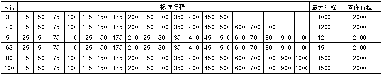

±ê×¼ÐгÌ

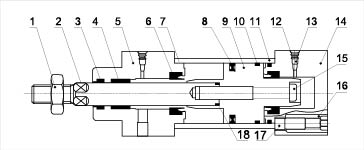

ÄÚ²¿½á¹¹
ʾÀý
Óû¶©¹º¸×¾¶Îª63mm£¬ÐгÌΪ80mm£¬¸½´Å, ²ÉÓÃLB¹Ì¶¨ÐÍʽµÄ±ê×¼¸´¶¯ÐÍÆø¸×£¬ÆäÕýÈ·µÄ¶©¹ºÂë´úºÅΪ: SU-63 x 80-S-LB.

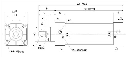

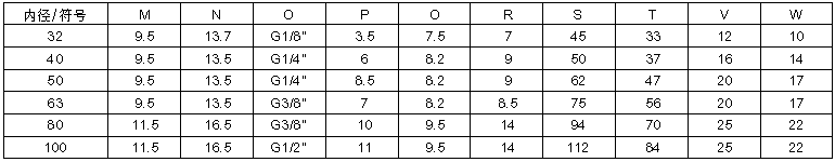

SU Æø¸×»ù±¾Ðͼ°³ß´ç
