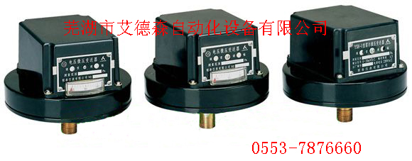

YSG-02¡¢03Ð͵ç¸Ð΢ѹ±äËÍÆ÷
Ò»¡¢ÓÃ;ÓÚÌØµã YSGϵÁеç¸ÐѹÁ¦Öµ£¬±ãÓÚÏÖ³¡¼ì²éÓÚµ÷У£¬Í¬Ê±»¹½«±»²â½éÖʵÄѹÁ¦Öµ×ª»»³É0¡«10mA¡¢DC»ò4¡«20mA¡¢DCµÄ±ê×¼Ö±Á÷Ðźţ¬±ãÓڽϳ¤¾àÀë´«ËÍ¡£¾ßÓÐÖ±¹Û¡¢Îȶ¨ÐԺá¢ÎÂÆ¯Ð¡µÈÓŵ㣬¿ÉÓÃÓÚ¸÷ÖÖ¹¤×÷Éú²ú¹ý³ÌºÍ²âÁ¿ÏµÍ³ÖÐÒºÌå¡¢ÆøÌå¿ÉÕôÆûµÈ½éÖʵÄѹÁ¦»ò¸ºÑ¹µÄ²âÁ¿¼°ÐźŴ«ËÍ£¬ÊµÏÖÉú²ú¹ý³ÌµÄ×Ô¶¯¼ì²âÓÚ¿ØÖÆ¡£ |
¶þ¡¢Ö÷Òª¼¼Êõ²ÎÊý¼°ÐÔÄÜ
| ÐͺŠ|
YSG-02 |
YSG-03 |
| ¹¤×÷µçÔ´ |
220V A.C. |
24V DC. |
| Êä³öÐźŠ|
0¡«10mA.D.C. |
4¡«20mA.D.C. |
| ¸ºÔصç×è |
¡Ü1K¦¸ |
¡Ü250K¦¸ |
| ½ÓÏß¶Ë×Ó²¼Ïß |
¢Ù+¢Ú-0¡«10mA DC¢Û¢Ü220VA.C. ¢Ý |
¢Ù+¢Ú 24VDC 4¡«20mA.D.C. |
| ÖØÁ¿£¨kg) |
1.3 |
1.0 |
·Ö¶È·¶Î§ £¨KPa£© |
0¡«1;0¡«1.6;0¡«2.5;0¡«4; 0¡«6;10;16;25;40;60;-1-0;-2.5-0;-4-0;-6-0;-10-0;-16-0;-20-20;-25-0;-40-0;
| ¾«È·¶ÈµÈ¼¶ |
2.5¼¶ | | | |
