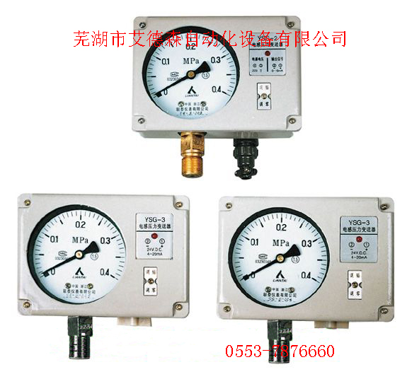

YSGµç¸ÐʽѹÁ¦±äËÍÆ÷
Ò»¡¢ÓÃ;ÓÚÌØµã
    YSGϵÁеç¸ÐѹÁ¦Öµ£¬±ãÓÚÏÖ³¡¼ì²éÓÚµ÷У£¬Í¬Ê±»¹½«±»²â½éÖʵÄѹÁ¦Öµ×ª»»³É0¡«10mA¡¢DC»ò4¡«20mA¡¢DCµÄ±ê×¼Ö±Á÷Ðźţ¬±ãÓڽϳ¤¾àÀë´«ËÍ¡£¾ßÓÐÖ±¹Û¡¢Îȶ¨ÐԺá¢ÎÂÆ¯Ð¡µÈÓŵ㣬¿ÉÓÃÓÚ¸÷ÖÖ¹¤×÷Éú²ú¹ý³ÌºÍ²âÁ¿ÏµÍ³ÖÐÒºÌå¡¢ÆøÌå¿ÉÕôÆûµÈ½éÖʵÄѹÁ¦»ò¸ºÑ¹µÄ²âÁ¿¼°ÐźŴ«ËÍ£¬ÊµÏÖÉú²ú¹ý³ÌµÄ×Ô¶¯¼ì²âÓÚ¿ØÖÆ¡£
¶þ¡¢Ö÷Òª¼¼Êõ²ÎÊý¼°ÐÔÄÜ
ÐͺŠYSG-2(A) YSG-3(A)
¹¤×÷µçÔ´ 220V  A.C. 24V  DC.
Êä³öÐźŠ0¡«10mA.D.C. 4¡«20mA.D.C.
¸ºÔصç×è ¡Ü1K¦¸ ¡Ü250K¦¸
½ÓÏß¶Ë×Ó²¼Ïß ¢Ù+¢Ú-0¡«10mA
DC¢Û¢Ü220VA.C.
¢Ý
¢Ù+¢Ú
24VDC
4¡«20mA.D.C.
ÖØÁ¿£¨kg) 1.3 1.0
·Ö¶È·¶Î§
£¨KPa£©
0¡«1;0¡«1.6;0¡«2.5;0¡«4;
0¡«6;10;16;25;40;60;-1-0;-2.5-0;-4-0;-6-0;-10-0;-16-0;-20-20;-25-0;-40-0;
¾«È·¶ÈµÈ¼¶ 2.5¼¶
