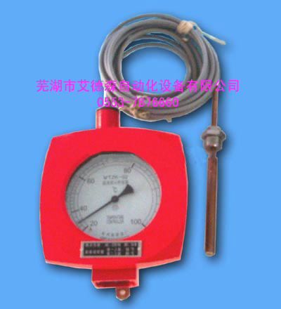

WTZK-0ζȿØÖÆÆ÷          WTZK-01ζȿØÖÆÆ÷ѹÁ¦Ê½Î¶Èָʾ¿ØÖÆÆ÷
ÐͺÅ
ÊÊÓ÷¶Î§
²âÁ¿·¶Î§¡æ
¾«¶È
     ½á¹¹mm
WTZK-01
ÓÃÓÚ»§Íâ²âÁ¿20 Ã×ÒÔÄÚµÄÒºÌå¡¢ÆøÌåºÍÕôÆûµÄζȣ¬²¢ÄÜÔÚ¹¤×÷ζȴﵽºÍ³¬¹ý¸ø¶¨ÖµÊ±·¢³öµçÐźţ¬»¹¿ÉÒÔ×÷Ϊζȵ÷½ÚϵͳÄڵĵç·¿ØÖÆ¿ª¹Ø¡£ÎÂ¿ØÆ÷µç½Óµã¾ßÓÐË«ÉÏÏÞ×°Ö㬸ù¾ÝÐèҪרÓÃÔ¿³×µ÷ÕûË«ÉÏÏÞµãλÖá£
0~50£¬
-20~60
2.5
°²×°ÂÝÎÆ£ºM27¡Á2£»
ΰü²åÈëÉî¶È£º160~260,210~310 £»
ëϸ¹Ü³¤¶ÈΪ1~20m
0~100
20~120
60~160
1.5
WTZK-02
ÓÃÓÚ´óÐͱäѹÆ÷ÓÍβâÁ¿£¬²¢Äܹ»ÔÚÓÍδﵽºÍ³¬¹ýζÈÉ趨ֵʱÊä³öÁ½¸ö£¨µÚÒ»ÉÏÏÞ¡¢µÚ¶þÉÏÏÞ£©µçÐźţ¬
20~100
1.5
2.5
ÍâÐγߴ磺210¡Á144
ΰü³ß´ç£º¦µ14¡Á150
°²×°ÂÝÎÆ£ºM27¡Á2
²åÈëÉî¶È£º150~260
ëϸ¹Ü³¤¶ÈΪ1~20m

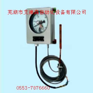

WTZK-803(¸Ä½øÐÍ)±äѹÆ÷ζȿØÖÆÆ÷
BWY(WTYK)-802A¡¢803AÎÂ¿ØÆ÷²ÉÓø´ºÏ´«¸ÐÆ÷¼¼Êõ£¬¼´ÒDZíΰüÍÆ¶¯µ¯ÐÔÔª¼þµÄͬʱ£¬ÄÜͬ²½Êä³öPt100Èȵç×èÐźţ¬´ËÐźſÉÔ¶´«µ½Êý°ÙÃ×ÒÔÍâµÄ¿ØÖÆÊÒ£¬Í¨¹ýXMTÊýÏÔοØÒÇͬ²½ÏÔʾ²¢¿ØÖƱäѹÆ÷ÓÍΡ£Ò²¿Éͨ¹ýÊýÏÔÒÇ±í£¬½«Pt100Èȵç×èÐźÅת»»³ÉÓë¼ÆËã»úÁªÍøµÄÖ±Á÷±ê×¼ÐźÅ(0¡«5V¡¢1¡«5V¡¢4¡«20mA)Êä³ö¡£²ÉÓÃÍâÖýÓÏߺз½±ãÓû§½ÓÏß¡£
Ö÷Òª¼¼ÊõÊý¾Ý
    (Ò») BWY(WTYK)-802¡¢803ÐÍ
    1¡¢ Õý³£¹¤×÷Ìõ¼þ£º-30¡«+55¡æ
    2¡¢ ²âÁ¿·¶Î§£º-20¡«+80¡æ
    0¡«+100¡æ
    0¡«+120¡æ
    0¡«+150¡æ
    3¡¢ ָʾ¾«È·¶È£º1.5¼¶
    4¡¢ ¿ØÖÆÐÔÄÜ£º¢ÙÉ趨·¶Î§£ºÈ«Á¿³Ì¿Éµ÷
     ¢ÚÉ趨¾«È·¶È£º¡À3¡æ
     ¢Û¿ª¹Ø²î£º6¡À2¡æ
     ¢Ü¶î¶¨¹¦ÂÊ£ºAC 220V/3A
     ¢Ý±ê×¼É趨ֵ£º
    802£ºK1=55¡æ£» K2=80¡æ£»
    803£ºK1=55¡æ£» K2=65¡æ£»K3=80¡æ
WTZK-802¡¢803±äѹÆ÷ζȿØÖÆÆ÷
BWY£¨WTYK£©-802A¡¢803AÎÂ¿ØÆ÷²ÉÓø´ºÏ´«¸ÐÆ÷¼¼Êõ£¬¼´ÒDZíΰüÍÆ¶¯µ¯ÐÔÔª¼þµÄͬʱ£¬ÄÜͬ²½Êä³öPt100Èȵç×èÐźţ¬´ËÐźſÉÔ¶´«µ½Êý°ÙÃ×ÒÔÍâµÄ¿ØÖÆÊÒ£¬Í¨¹ýXMTÊýÏÔοØÒÇͬ²½ÏÔʾ²¢¿ØÖƱäѹÆ÷ÓÍΡ£Ò²¿Éͨ¹ýÊýÏÔÒÇ±í£¬½«Pt100Èȵç×èÐźÅת»»³É¼ÆËã»úÁªÍøµÄÖ±Á÷±ê×¼Ðźţ¨0¡«5V¡¢1¡«5V¡¢4¡«20mA£©Êä³ö¡£
Ö÷Òª¼¼ÊõÊý¾Ý
    1¡¢ Õý³£¹¤×÷Ìõ¼þ£º-33¡«+55¡æ
    0¡«+100¡æ
    0¡«+120¡æ
    0¡«+150¡æ
    3¡¢ ָʾ¾«È·¶È£º1.5¼¶
    4¡¢ ¿ØÖÆÐÔÄÜ£º
     ¢ÚÉ趨¾«È·¶È£º¡À3¡æ
     ¢Û¿ª¹Ø²î£º6¡À2¡æ
     ¢Ý±ê×¼É趨ֵ£º
    802£ºK1=55¡æ£»K2=80¡æ
    803£ºK1=55¡æ£»K2=65¡æ£»K3=80¡æ
