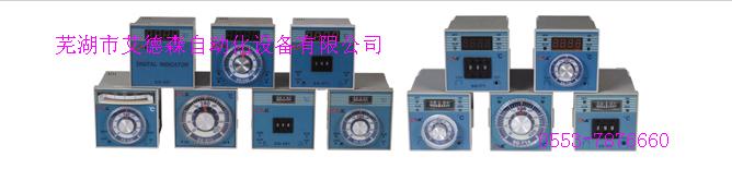

 SGϵÁÐÒDZí
Ò»¡¢ÊÊÓ÷¶Î§
±¾¹«Ë¾Éú²úµÄSGϵÁÐÒÇ±í£¬ÍêÈ«²ÉÓýø¿ÚÔªÆ÷¼þÖÆÔ죬²úÆ·Ìå»ýС¡¢ÖØÁ¿Çá¡¢ÍâÐÎÃÀ¡¢¿É¿¿ÐԺ㬿¹Õ𶯺Ϳ¹¸ÉÈÅÄÜÁ¦Ç¿¡£Ó¦Óù㷺£¬¿ÉÍêÈ«Ìæ´úͬÀà½ø¿ÚÒÇ±í¡£
¶þ¡¢Ö÷Òª¼¼ÊõÊý¾Ý
Àà±ðClassification 72mm¡Á72mm 96mm¡Á96mmζȿØÖÆÆ÷
72mm¡Á72mm 96mm¡Á96mm Temperature Controller
³ß´çDimensions(mm) 72H¡Á72W¡Á100D 96H¡Á96W¡Á100D
ʹÓÃζȷ¶Î§Scale range DIGIT SETTING£º0-99.9¡æ, 0-199¡æ, 0-299¡æ, 0-399¡æ, 0-999¡æ
ÊäÈë¹æ¸ñInput type CA(K¡¢J),PT100¦¸
É趨¾«¶ÈSetting accuracy ¡À1% È«¿Ì¶ÈÒÔÄÚ»òÏÔʾÁ¿³ÌÄÚ
Less than ¡À1% full scale
¡À0.5% È«¿Ì¶ÈÒÔÄÚ»òÏÔʾÁ¿³ÌÄÚ
Less than 0.5% full scale
ָʾ¾«¶ÈIndicated accuracy ¡À2¡æÒÔÄÚ
Less than¡À2¡æ
¿ØÖƶ¯×÷Control form ON/OFFʽ£¬±ÈÀýʽ(PD)
ON/OFF only, proporation(PD)
Êä³ö·½Ê½Output model ¼ÌµçÆ÷½Óµã5A 250VAC£¬ ÎÞ½Óµãµçѹ DC12V¹©SSRʹÓÃ
Relay SPDT 5A 250VAC, 12VDC for SSR drive
¶î¶¨µçѹRated voltage AC£º110V/220V/380V¡À10%£¬50/60Hz
±ÈÀýÖÜÆÚProportional cycle ¼ÌµçÆ÷£º15Ã룬Î޽ӵ㣺2Ãë
Relay output:15sec,SSR output:2sec
ÏûºÄ¹¦ÂÊConscumed power About:3W
¸½Êô¹¦ÄÜAccessory Function ¸ÐÎÂÏß¶ÏÏß¼ìÖª
Recognition sensor break
ʹÓÃÖÜΧζÈAmbient temperature -10¡æ~+55¡æ
