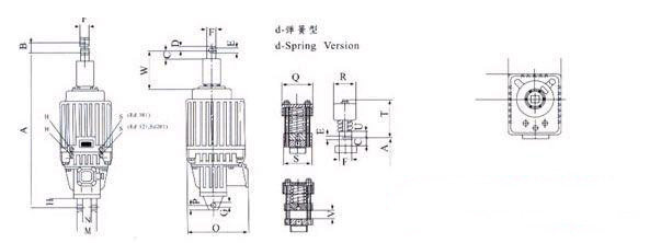

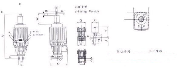

Èý¡¢²úÆ·³ß´çÓø½Í¼
ÐͺÅ
A
B
C
D
E1
F
G2
H
K
L
M
N
O
P
Q
R
S
T
U
V
W
60
38
25
25
40
25
35
240
112
90
40
260
25
130
80
120
147
35
20
130
YTD2£¨ED£©-300/50
645
60
38
25
25
40
25
35
240
112
90
40
260
25
130
80
120
147
35
20
130
YTD2£¨ED£©-500/60
645
120
38
25
25
40
25
35
240
112
90
40
260
25
130
80
120
147
35
20
130
YTD2£¨ED£©-800/60
705
120
38
25
25
40
25
35
240
112
90
40
260
25
190
705
120
38
25
25
40
25
35
240
112
90
40
260
25
190
ÐͺÅ
A
B
C
D
E1
F
G2
H
K
L
M
N
O
P
Q
R
S
T
U
V
W
YTD2£¨ED£©-1250/60
645
60
38
25
25
40
25
35
240
112
90
40
260
25
130
80
120
147
35
20
130
120
38
25
25
40
25
35
240
112
90
40
260
25
130
80
120
147
35
20
130
YTD2£¨ED£©-1250/120
705
120
38
25
25
40
25
35
240
112
90
40
260
25
190
YTD2£¨ED£©-2000/120
705
120
38
25
25
40
25
35
240
112
90
40
260
25
190
190
