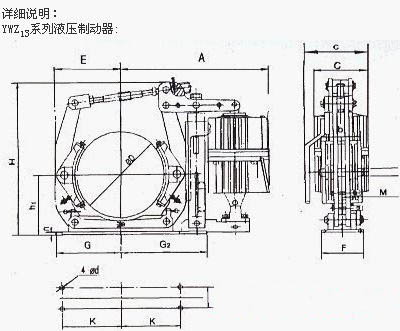

¼¼Êõ²ÎÊý¡¢ÍâÐγߴç±í(mm)
ÐͺÅ
ÖÆ¶¯Á¦¾Ø
Í˾Ø
A
b
C
c
D
d
E
F
G1
G2
H
h1
f
K
M
n
ÖØÁ¿
ÖÆ¶¯Æ÷
Æ¥ÅäÍÆ¶¯Æ÷
YWZ13-200/23
Ed23/5
50-300
0.7
345
190
160
195
17
200
167
100
195
250
460
170
60
175
155
8
32
Ed30/5
85-400
43
YWZ13-300/30
Ed30/5
130-300
0.8
570
140
160
195
22
300
247
130
275
300
605
240
80
300
240
12
65
YWZ13-300/50
Ed50/6
250-550
660
195
230
80
Ed80/6
400-900
92
YWZ13-400/50
Ed50/6
400-600
1.2
675
180
195
230
22
400
302
180
350
400
750
810
320
130
400
248
14
120
YWZ13-400/80
Ed80/6
600-1120
130
Ed121/6
1000-1900
240
280
150
YWZ13-500/80
Ed80/6
800-1300
1.2
775
200
240
230
22
500
372
200
405
455
950
400
150
500
410
16
220
YWZ13-500/121
Ed121/6
1400-2240
280
YWZ13-500/201
Ed201/6
2240-3550
765
YWZ13-600/121
Ed121/6
Ed201/6
YWZ13-600/301
Ed301/6
YWZ13-700/201
Ed201/6
Ed301/6
