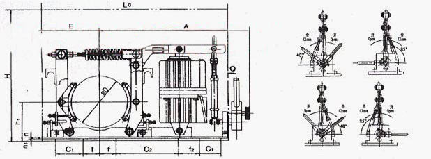

YWZ12ϵÁÐÒºÑ¹ÖÆ¶¯Æ÷:
¼¼Êõ²ÎÊý¡¢ÍâÐγߴç±í(mm)
ÖÆ¶¯Æ÷ÐͺÅ
Æ¥ÅäÍÆ¶¯Æ÷
ÖÆ¶¯Á¦¾Ø
Í˾Ø
A
B
B1
B2
b
F
C1
C2
D
d
E
YWZ12-200/23S
Ed23/5S
80-130
1
840
180
230
80
280
160
220
200
14
260
Ed30/5S
80-200
YWZ12-250/23S
Ed23/5S
100-170
1.2
970
220
260
100
300
200
250
250
18
305
Ed30/5S
100-240
YWZ12-250/50S
Ed50/6S
220-500
YWZ12-315/30S
Ed30/5S
230-280
1.2
1120
260
125
330
200
280
315
18
380
YWZ12-315/50S
Ed50/6S
430-550
Ed80/6S
430-1050
YWZ12-400/50S
Ed50/6S
510-630
1.5
1270
280
160
400
180
300
400
22
440
YWZ12-400/80S
Ed80/6S
510-1000
YWZ12-400/121S
Ed121/6S
820-1800
YWZ12-500/80S
Ed80/6S
970-1200
2
1400
300
200
440
200
330
500
22
510
Ed121/6S
970-2000
YWZ12-500/201S
Ed201/6S
1500-3200
YWZ12-630/121S
Ed121/6S
1200-2100
2
1615
360
250
260
260
630
27
615
YWZ12-630/201S
Ed201/6S
2000-3600
YWZ12-630/301S
Ed301/6S
2800-5300
Ed301/12S
3500-7000
1730
40
260
260
27
615
f
f2
H
h1
i
K
L
m
n
n1
Q
t
¦Õ
ÖØÁ¿
80
665
160
55
145
820
450
10
5
55
280
106
60
65
100
774
190
65
180
948
550
14
4
55
350
126
85
90
102
150
775
225
80
220
1100
12
4
55
350
166
110
120
127
180
800
280
110
270
1251
14
4
70
650
186
170
170
950
205
330
958
335
130
325
1581
16
4
70
650
216
250
275
275
240
230
1128
425
170
400
1587
20
8
74
850
226
657
390
390
260
260
1288
425
170
400
1697
20
8
74
850
226
480
