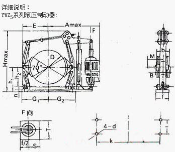

¼¼Êõ²ÎÊý¡¢ÍâÐγߴç±í(mm)
ÐͺÅ
ÖÆ¶¯Êä³öÖ±¾¶
ÖÆ¶¯Á¦¾Ø
Í˾Ø
Æ¥ÅäÍÆ¶¯Æ÷ÐͺÅ
µç»ú¹¦ÂÊ
ÿСʱ¶¯×÷´ÎÊý
ÖØÁ¿
D
h1
h2
G1
G2
f
k
i
d
200
112-224
1
Ed23/5
120
1200
26.6
200
160
125
165
195
90
145
55
14
YWZ5-200/30
200
140-315
1
Ed30/5
180
1200
32.6
YWZ5-250/23
250
140-224
1.25
Ed23/5
120
1200
37.6
250
190
150
200
223
100
180
65
18
YWZ5-250/30
250
180-315
1.25
Ed30/5
180
1200
43.6
YWZ5-315/23
315
180-280
1.25
Ed23/5
120
1200
44.6
315
225
185
238
268
110
220
80
16
315
250-400
1.25
Ed30/5
180
1200
50.6
YWZ5-315/50
315
400-630
1.25
Ed50/6
250
1200
61.4
YWZ5-315/80
315
630-1000
1.25
Ed80/6
370
1200
62.4
400
400-800
1.6
Ed50/6
250
1200
78.4
400
280
220
300
350
140
270
100
22
YWZ5-400/80
400
630-1250
1.6
Ed80/6
370
1200
79.4
YWZ5-400/121
400
1000-2000
1.6
Ed121/6
370
1200
93.8
500
800-1400
1.6
Ed80/6
370
1200
124.4
500
335
280
365
372
180
325
130
22
YWZ5-500/121
500
1120-2240
1.6
Ed121/6
370
1200
135.8
YWZ5-500/201
500
2000-3600
1.6
Ed201/6
550
700
138.6
630
1800-2800
2
Ed121/6
370
1200
185.8
630
425
330
450
450
220
400
170
27
YWZ5-630/201
630
2500-4000
2
Ed201/6
550
700
188.3
YWZ5-630/301
630
4000-6300
2
Ed310/6
750
700
191.0
YWZ5-710/201
710
3150-5000
2
Ed210/6
550
700
233.3
710
475
380
500
500
240
450
190
27
710
5000-8000
2
Ed301/6
750
700
236.0
n
E
M
B
b
T
S
Hmax
Smax
15
165
110
92
80
160
120
487
448
117
445
17
197
120
112
100
160
120
553
503
117
500
17
240
145
132
125
160
120
573
538
117
535
195
157
575
20
299
170
156
160
195
157
174
665
240
148
760
656
20
365
245
204
200
195
157
845
754
210
148
754
30
450
293
242
250
240
148
1015
835
30
505
315
260
280
240
148
1057
923
