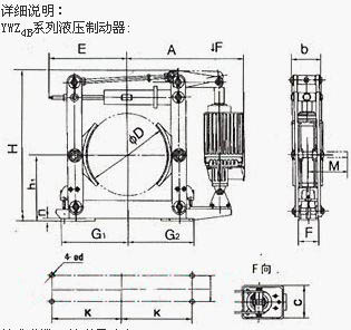

Ïêϸ˵Ã÷£º
YWZ4BϵÁÐÒºÑ¹ÖÆ¶¯Æ÷:
¼¼Êõ²ÎÊý¡¢ÍâÐγߴç±í(mm)
ÐͺÅ
ÖÆ¶¯Á¦¾Ø
Í˾Ø
A
b
c
D
d
E
F
G1
G2
H
h1
I
k
M
n
ÖØÁ¿
£¨kg£©
ÖÆ¶¯Æ÷
Æ¥ÅäÍÆ¶¯Æ÷ÐͺÅ
Ed 23/5
40
0.6
320
70
160
100
13
125
75
125
125
375
100
40
110
162
6
22
YWZ4B-150/23
Ed 23/5
100
0.6
350
90
160
150
17
173
100
170
170
430
140
60
150
162
8
23
YWZ4B-200/23
Ed 23/5
200
0.7
427
90
160
200
17
210
100
195
195
431
170
60
175
189
8
31
YWZ4B-200/23
Ed 30/5
220
430
463
24
Ed 30/5
320
0.7
527
140
160
300
22
281
130
280
280
595
240
80
250
240
10
65
YWZ4B-300/50
Ed 50/6
630
195
585
78
YWZ4B-300/80
Ed 80/6
750
557
195
600
79
Ed 50/6
1000
0.8
662
180
195
400
22
370
180
360
360
735
320
130
325
315
15
128
YWZ4B-400/80
Ed 80/6
1600
693
140
Ed 121/6
2000
240
155
YWZ4B-500/121
Ed 121/6
2500
0.8
713
200
240
500
22
440
200
415
415
925
400
150
380
375
15
210
YWZ4B-500/201
Ed 201/6
3600
YWZ4B-600/121
Ed 121/6
3200
0.8
848
240
240
600
26
555
220
505
520
1100
475
170
475
458
18
390
Ed 201/6
5000
390
YWZ4B-700/201
Ed 201/6
8000
0.8
978
280
240
700
34
705
270
580
600
1245
550
200
540
585
25
465
YWZ4B-700/301
Ed 301/6
8650
466
Ed 301/6
12500
0.9
1115
320
240
800
34
772
320
677
697
1417
600
240
620
375
25
885
