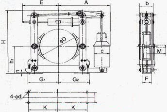

²úÆ·Ãû³Æ£º
YWZB-300/45.YWZB-400/125ÒºÑ¹ÖÆ¶¯Æ÷
ÐÍ ºÅ£º
0.00
2614
Ïêϸ˵Ã÷£º
| ¼¼Êõ²ÎÊý¡¢ÍâÐγߴç±í(mm) |
ÖÆ¶¯Æ÷ÐͺŠ|
Æ¥ÅäÍÆ¶¯Æ÷ÐͺŠ|
ÖÆ¶¯Á¦¾Ø |
ÎÂ¾Ø |
A |
b |
C |
d |
E |
F |
G1 |
G2 |
H |
h1 |
i |
k |
M |
n |
ÖØÁ¿ |
YWZB-100/18 |
YT1-18Z/2 |
40 |
0.7 |
269 |
70 |
137 |
13 |
125 |
75 |
125 |
125 |
384 |
100 |
40 |
110 |
138 |
6 |
25 |
YT1-25Z/4 |
100 |
0.7 |
307 |
90 |
154 |
17 |
173 |
100 |
170 |
170 |
437 |
140 |
60 |
150 |
138 |
8 |
33 |
YWZB-200/25 |
YT1-25Z/4 |
200 |
0.7 |
347 |
90 |
154 |
17 |
210 |
100 |
195 |
195 |
440 |
170 |
60 |
175 |
156 |
8 |
42 |
YT1-25Z/4 |
320 |
0.7 |
447 |
140 |
154 |
22 |
281 |
130 |
280 |
280 |
592 |
240 |
80 |
250 |
200 |
10 |
73 |
YWZB-300/45 |
YT1-45Z/6 |
630 |
0.7 |
459 |
140 |
178 |
22 |
281 |
130 |
280 |
280 |
600 |
240 |
80 |
250 |
200 |
10 |
80 |
YWZB-300/90 |
YT1-90Z/8 |
800 |
0.7 |
140 |
210 |
22 |
281 |
130 |
280 |
280 |
645 |
240 |
80 |
250 |
200 |
10 |
100 |
YT1-45Z/6 |
1000 |
0.8 |
564 |
180 |
178 |
22 |
370 |
180 |
360 |
360 |
740 |
320 |
130 |
325 |
265 |
12 |
130 |
YWZB-400/90 |
YT1-90Z/8 |
1600 |
0.8 |
580 |
180 |
210 |
22 |
370 |
180 |
360 |
360 |
740 |
320 |
130 |
325 |
365 |
12 |
160 |
YWZB-400/125 |
YT1-125Z/10 |
2200 |
0.8 |
632 |
180 |
254 |
22 |
370 |
180 |
360 |
360 |
850 |
320 |
130 |
325 |
271 |
12 |
167 |
YT1-90Z/8 |
2500 |
0.8 |
765 |
200 |
210 |
22 |
440 |
200 |
415 |
415 |
885 |
400 |
150 |
380 |
310 |
16 |
220 |
YWZB-500/125 |
YT1-125Z/10 |
2650 |
0.8 |
775 |
200 |
254 |
22 |
440 |
200 |
415 |
415 |
885 |
400 |
150 |
380 |
310 |
16 |
220 |
YWZB-500/180 |
YT1-180Z/12 |
3200 |
0.8 |
775 |
200 |
254 |
22 |
440 |
200 |
415 |
415 |
885 |
400 |
150 |
380 |
310 |
16 |
220 |
YT1-90Z/8 |
3200 |
0.8 |
805 |
240 |
210 |
26 |
555 |
220 |
505 |
520 |
1082 |
475 |
170 |
475 |
390 |
18 |
400 |
YWZB-600/125 |
YT1-125Z/10 |
4000 |
0.8 |
827 |
240 |
254 |
26 |
555 |
220 |
505 |
520 |
1082 |
475 |
170 |
475 |
390 |
18 |
400 |
YWZB-600/180 |
YT1-180Z/12 |
5000 |
0.8 |
827 |
240 |
254 |
26 |
555 |
220 |
505 |
520 |
1082 |
475 |
170 |
475 |
390 |
18 |
430 |
YT1-180Z/12 |
8000 |
0.8 |
957 |
280 |
254 |
34 |
702 |
270 |
580 |
600 |
1225 |
550 |
200 |
540 |
585 |
25 |
500 |
YWZB-800/180 |
YT1-180Z/12 |
10000 |
0.8 |
1094 |
320 |
254 |
34 |
772 |
320 |
677 |
697 |
1417 |
600 |
240 |
620 |
510 |
25 |
720 |
YT1-320Z/12 |
12500 |
0.8 |
1155 |
320 |
375 |
34 |
772 |
320 |
677 |
697 |
1417 |
600 |
240 |
620 |
1100 |
25 |
885 | | |
