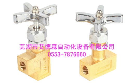

²úÆ·Ãû³Æ£º GCT,GCLT,NUL,NULL,NUѹÁ¦±í¿ª¹Ø
ÐÍ ºÅ£º
Æ· ÅÆ£º 2614
Ïêϸ˵Ã÷£º
ѹÁ¦±í¿ª¹Ø
¶¨»õÐͺÅ˵Ã÷
ÐͺÅ
±íÃæ¹æ¸ñ
GCT:ֱͨÖýÌú(180¡ã)
02: 1/4¡±
GCLT:Ö±½ÇÖýÌú(90¡ã)
03: 3/8¡±
NUL:ֱͨͭÖÊ(180¡ã)
04: 1/2¡±
NULL:Ö±½ÇÍ­ÖÊ(90¡ã)
06: 3/4¡±
NU:»º³åÆ÷Í­ÖÊ
08:1¡±
ÐÍʽºÅÂë
¹Ü¾¶PT
¸ñ¶¨Á÷Á¿(I/min)
×î¸ßʹÓÃѹÁ¦(bar)
ÖØÁ¿(kg)

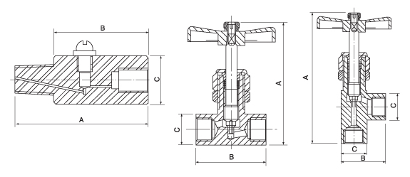

³ß´ç±í
A
B
C
GCT-02
1/4"
10
350
0.28
97
51
22
GCT-03
3/8"
21
0.28
97
51
22
GCLT-02
1/4"
10
0.32
122
37
22
GCLT-03
3/8"
21
0.32
122
37
22
NUL-02
1/4"
10
350
0.28
97
51
22
NUL-03
3/8"
21
0.28
97
51
22
NUL-04
1/2"
30
0.7
108
65
32
NUL-06
3/4"
100
1.10
135
80
38
NUL-08
1"
300
2.30
144
95
51
NULL-02
1/4"
10
0.32
122
37
22
NULL-03
3/8"
21
0.32
122
37
22
NU-02
1/4"
0.5
350
0.11
45
32
21
NU-03
3/8"
1
0.16
45
30
23
NU-04
1/2"
2
0.2
35
27
