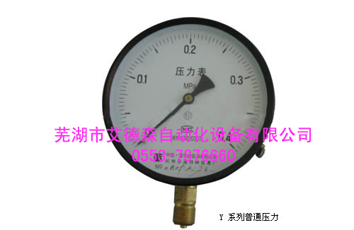

²úÆ·Ãû³Æ£º Y ϵÁÐÆÕͨѹÁ¦±í
ÐÍ ºÅ£º
Æ· ÅÆ£º 2614
Ïêϸ˵Ã÷£º
ÆÕͨѹÁ¦±í
>>ÓÃ;˵Ã÷
¡¡ ¸Ã±íÓÃÓÚ²âÁ¿¶ÔÍ­ºÍÍ­ºÏ½ðÎÞ¸¯Ê´ÐÔ¡¢ÎÞ±¬Õ¨ÐÔ¡¢ÇÒ²»½á¾§£¬²»³ÁµíµÄÆøÌå»òÒºÌåµÄѹÁ¦¡£
>> Ö÷Òª¼¼ÊõÖ¸±ê
Ãû ³Æ
ÐÍ ºÅ
¾«¶ÈµÈ¼¶
²âÁ¿·¶Î§
ʹÓû·¾³Ìõ¼þ
ζÈÓ°Ïì
Ò»°ãѹÁ¦±í
Y-40
2.5
0.1,0.16,0.25,0.4,0.6,1,1.6, 2.5,4,6
-40¡«+70¡æ£»Ïà¶Ôʪ¶È²»´óÓÚ85£¥¡£
ʹÓÃζÈÈçÆ«Àë20¡À5¡æÊ±£¬Æäζȸ½¼ÓÎó²î²»´óÓÚ0.4£¥/10¡æ
Y-60
2.5
0.1,0.16
0.25,0.4
0.6,1,1.6
2.5,4,6,10
16,25,40
60,100
-0.1¡«0,-0.1¡«0.06,
-0.1¡«0.15,-0.1¡«0.3
-0.1¡«0.5,-1¡«0.9
-0.1¡«1.5,-0.1¡«2.4
Y-100
1.6
Y-150
1.6
Y-200
1.6
Y-250
1.6
¾¶Ïò´øºó±ßѹÁ¦±í
Y-60T
2.5
Y-100T
1.6
Y-150T
1.6
ÖáÏò´øÇ°±ßѹÁ¦±í
Y-60TZ
2.5
Y-100TZ
1.6
Y-150TZ
1.6
ÖáÏòÎÞ±ßѹÁ¦±í
Y-40Z
2.5
Y-60Z
2.5
Y-100Z
1.6
Y-150Z
1.6
¾¶Ïò´øºó±ß
Y-60T
2.5
Y-100T
1.6
Y-150T
1.6
ÐͺÅ
D
d
d1
L
d0
B
H
d2
H1
H2
L1
Y-40
¦Õ40
M10¡Á1
¦Õ2.5
10
38
24
8.5
2
Y-40Z
¦Õ40
M10¡Á1
¦Õ2.5
10
40
24
0
2
Y-60
¦Õ60
M10¡Á1»òM14¡Á1.5
¦Õ5
14
56
30
12
2
Y-60Z
¦Õ60
M10¡Á1»òM14¡Á1.5
¦Õ5
14
58
30
0
2
Y-60T
¦Õ60
M10¡Á1»òM14¡Á1.5
¦Õ5
14
72
56
30
¦Õ4.5
13
2
Y-60ZT
¦Õ60
M10¡Á1»òM14¡Á1.5
¦Õ5
14
72
53
30
¦Õ4.5
24
0
2
Y-100
¦Õ100
M20¡Á1.5
¦Õ6
20
90
44
18
2
Y-100Z
¦Õ100
M20¡Á1.5
¦Õ6
20
85
44
30
2
Y-100T
¦Õ100
M20¡Á1.5
¦Õ6
20
118
90
45
¦Õ5.5
18
2
Y-100ZT
¦Õ100
M20¡Á1.5
¦Õ6
20
118
85
44
¦Õ5.5
39
30
2
Y-150
¦Õ150
M20¡Á1.5
¦Õ6
20
115
48
18
2
Y-150Z
¦Õ150
M20¡Á1.5
¦Õ6
20
92
47
30
2
Y-150T
¦Õ150
M20¡Á1.5
¦Õ6
20
165
115
48
¦Õ5.5
18
2
Y-150ZT
¦Õ150
M20¡Á1.5
¦Õ6
20
165
92
47
¦Õ5.5
41
30
2
Y-200
¦Õ200
M20¡Á1.5
¦Õ6
20
146
18
2
Y-250
¦Õ200
M20¡Á1.5
¦Õ6
20
167
18
