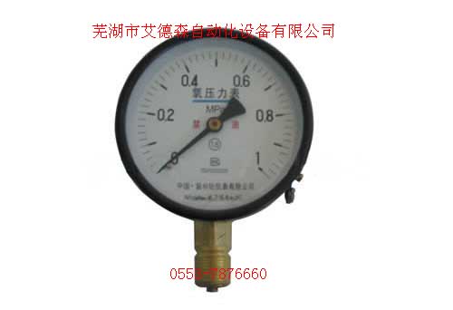

²úÆ·Ãû³Æ£º °±Æø¡¢ÑõÆø¡¢ÒÒȲѹÁ¦±í
ÐÍ ºÅ£º
Æ· ÅÆ£º 2614
Ïêϸ˵Ã÷£º
>>ÓÃ;˵Ã÷
¡¡¡¡ÒDZíÊÊÓòâÁ¿ÑõÆø½éÖʵÄѹÁ¦¡£ÑϽû½Ó´¥ÓÍÖ¬ÀàÎïÖÊ¡£
>> Ö÷Òª¼¼ÊõÖ¸±ê
ÐÍ ºÅ Model
¹«³ÆÖ±¾¶ Nominal Diameter(mm)
¾«¶ÈµÈ¼¶Accruacy
²âÁ¿·¶Î§
Measuring range(Mpa)
Á¬½ÓÂÝÎÆConnection
Yo-60
¦Õ60
2.5
0.16,0.25,0.4,0.6,1,1.6, 2.5,4,6,10,16,25,40,60
M14¡Á1.5
Yo-100
¦Õ100
1.6
M20¡Á1.5
Yo-150
¦Õ150
M20¡Á1.5

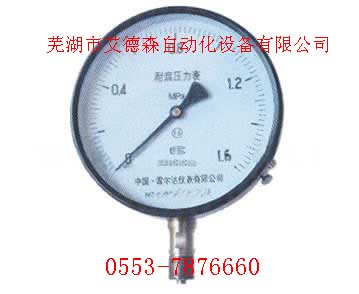

>>ÓÃ;˵Ã÷
¡¡¡¡°±ÆøÑ¹Á¦±íÓÃÓÚ²âÁ¿¶ÔÆÕ̼ͨϵ¸Ö¡¢ºÏ½ð½á¹¹¸Ö¡¢°ÂÊÏÌåÀ಻Ðâ¸Ö¼°ÎýºÏ½ðÏ˺¸ÁÏÎÞ¸¯Ê´×÷Ó㬷ǽᾧºÍÄý¹ÌµÄ¸÷ÖÖ½éÖʵÄѹÁ¦¡£Ö÷ÒªÊÊÓÃÓÚ»¯·ÊÉú²ú¹ý³ÌÖкÍÖÆÀäÉ豸ÖÐÓÃÀ´²âÁ¿°±µÄÒºÌå¡¢ÆøÌå»òÆä»ìºÏÎïµÈµÄѹÁ¦¡£
>> Ö÷Òª¼¼ÊõÖ¸±ê
ÐͺÅ
¾«È·¶ÈµÈ¼¶
ʹÓû·¾³Ìõ¼þ
ζÈÓ°Ïì
²âÁ¿·¶Î§
YA-100 YA-150
1.6
-40¡«+70¡æ£¬Ïà¶ÔζȲ»´óÓÚ90£¥
ʹÓÃζÈÈçÆ«Àë20¡À5¡æÊ±£¬Æäζȸ½¼ÓÎó²î²»´óÓÚ0.4£¥/10¡æ
0¡«0.1,0¡«0.16,0¡«0.25,0¡«0.4,0¡«0.6,0¡«1,0¡«1.6,0¡«2.5,0¡«4,0¡«6,0¡«10,0¡«16,0¡«25,0¡«40,0¡«60,-0.1¡«0,-0.1¡«0.06,-0.1¡«0.15,-0.1¡«0.3,-0.1¡«0.5,-0.1¡«0.9,-0.1¡«1.5,-0.1¡«2.4
>>½á¹¹Ô­Àí
¡¡¡¡ÒDZíÓɵ¼Ñ¹ÏµÍ³£¨°üÀ¨½ÓÍ·¡¢µ¯»É¹ÜµÈ£©¡¢´«¶¯»ú¹¹¡¢Ö¸Ê¾×°ÖúÍÍâ¿Ç×é³É¡£
¡¡¡¡µ±±»²â½éÖÊ×÷ÓÃÓÚµ¯»É¹Üʱ£¬Æä¹Ü¶Ë²úÉúÏàÓ¦µÄµ¯ÐÔ±äÐΡª¡ªÎ»ÒÆ£¬¾­´«¶¯»ú¹¹·Å´óºó£¬ÓÉָʾװÖÃÔÚ¶ÈÅÌÉϰѱ»²âѹÁ¦Ö¸Ê¾³öÀ´¡£
ÐͺÅ
D
H
L
S
YA-100
100
87
20
17
YA-150
150
116
