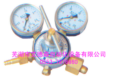

¼õѹÆ÷ϵÁР
¼õѹÆ÷ϵÁÐ
>>ÓÃ;˵Ã÷
¡¡¡¡¼õѹÆ÷ϵÁÐÊÊÓÃÓÚÔÚº¸½Ó¡¢ÇиÀàËÆ¹¤ÒÕ¹ý³ÌÖУ¬Ñ¹Á¦ÔÚ30MÒÔÄÚµÄѹËõÆøÌå¡¢ÈÛ½âÒÒȲ¡¢Òº»¯Ê¯ÓÍÆø¡¢¼×»ùÒÒȲһ±û¶þÏ©»ìºÏÎïºÍ¶þÑõ»¯Ì¼µÈÆøÆ¿ÓüõѹÆ÷¡£
>> Ö÷Òª¼¼ÊõÖ¸±ê
ÐÍ ºÅ Modes
YQY-06
YQY-07
YQY-08
YQE-03
½éÖÊ Service Medirm
ÑõÆø
ÑõÆø
ÑõÆø
ÒÒȲ
ÊäÈëѹÁ¦ Inlet Pressure
25Mpa
25Mpa
25Mpa
4Mpa
µ÷½Ú·¶Î§ Adjusting Range
¡¡0.1¡«1Mpa
0.1¡«1.25Mpa
0.1¡«2.0Mpa
0.1¡«0.15Mpa
½ø¿ÚÂÝÎÆ Inlet Connection
G5/8
G5/8
G5/8
M20¡Á1.5
³ö¿ÚÂÝÎÆ Outlet Connection
M16¡Á1.5
M16¡Á1.5
M16¡Á1.5
M16¡Á1.5
ÐÍ ºÅ Modes
YQD-37A
YGE-1
YQT-06A
YQQ-09
YQAr-731L
½éÖÊ Service Medirm
µªÆø
¹¤ÒµÈ¼Æø
¶þÑõ»¯Ì¼
ÇâÆø
ë²Æø
25Mpa
2.5Mpa
16Mpa
25Mpa
25Mpa
0.1¡«1.25Mpa
0.1¡«0.15Mpa
0.1¡«0.4Mpa
0.1¡«0.2Mpa
1¡«25Mpa
G5/8
M20¡Á1.5
G5/8
G5/8
G5/8
M16¡Á1.5
M16¡Á1.5
M16¡Á1.5
M16¡Á1.5
M10¡Á1
