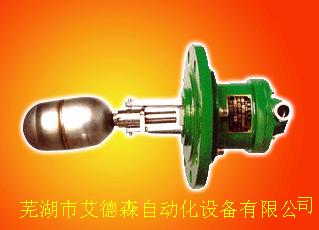

BUQKϵÁзÀ±¬¸¡ÇòҺλ¿ØÆ÷
Ò»¡¢¸ÅÊö
BUQKϵÁзÀ±¬¸¡ÇòҺλ¿ØÖÆÆ÷£¨ÒÔϼò³Æ¿Ø ÖÆÆ÷£©£¬ÊÊÓÃÓÚÉú²ú¹ý³ÌÈÝÆ÷ÄڵĽéÖÊÒº¿ØÖÆ£¬ ÓëÉù¹â±¨¾¯ÅäÌ×½øÐÐÉù¹â±¨¾¯¡£Ëü¹ã·ºÓ¦ÓÃÓÚʯ ÓÍ£¬»¯¹¤£¬ÇṤ¼°¹©ÅÅË®µÈ¹¤Òµ²¿ÃÅ¡£
¶þ¡¢Ìصã
½á¹¹¼òµ¥¡¢ÐÔÄÜÎȶ¨¿É¿¿ ¡¡¡¡ Ä͸¯Ê´¡¢ÄÜ·À±¬
Èý¡¢Ö÷Òª¼¼ÊõÖ¸±ê
¡¡¡¡Ê¹ÓýéÖÊζȣº150¡æ
¡¡¡¡ ¹©µçµçÔ´Óëµç´¥µãÈÝÁ¿£º1.220V¡¤AC
¡¡¡¡¡¡¡¡¡¡¡¡¡¡¡¡¡¡¡¡¡¡¡¡¡¡ 2.110V¡¤AC£¬150VA
¡¡¡¡¡¡¡¡¡¡¡¡¡¡¡¡¡¡¡¡¡¡¡¡¡¡ 3.24V¡¤DC£¬1.2A£¨ÊÊÓÃÓÚ±¾Öʰ²È«ÐÍ¿ØÖÆÆ÷£©
¡¡¡¡ ·À±¬±êÖ¾£º¸ô±¬ÐÍΪd II BT4£¬±¾°²ÐÍib II CT4a
ÐÍʽ Ðͺж¯×÷½çÏÞ£¨mm£© ¶î¶¨¹¤×÷ѹÁ¦£¨Mpa£© Õû¶¨·½Ê½ °²×°·½Ê½ °²×°·¨À¼
¸ô±¬ÐÍ BUQK-01 10 £¨1.6£©
4.0
£¨6.3£©
²»¿Éµ÷Õû ˮƽ JB£¯T82.2-94.80DN
PN4.0£¬6.3Í¹Ãæ
BUQK-01N 60
BUQK-01T 40 ´¹Ö±
BUQK-02 25¡«550 Óм¶µ÷Õû ˮƽ
BUQK-03 8¡«1000 ÎÞ¼¶µ÷Õû ´¹Ö±
BUQK-04 10 ²»¿Éµ÷Õû Íâ²à¶¥µ× PN4.0
±¾ÖÊ
°²È«ÐÍ
BUQK-01 10 £¨1.6£©
4.0
£¨6.3£©
PN4.0£¬6.3MPaÍ¹Ãæ
BUQK-01N 60
BUQK-01T 40 ´¹Ö±
BUQK-04 10 ²»¿Éµ÷Õû Íâ²à¶¥µ× ×¢1
×¢1£º°²×°·¨ÎªJB/T82.2£­94Í¹Ãæ·¨À¼£¬DN40mm£¬PN£¨1.6£©¡¢£¨6.3£©MPa
