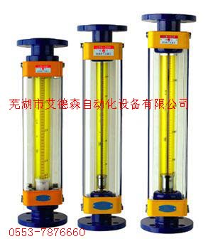

LZB²£Á§×ª×ÓÁ÷Á¿¼Æ
¸ÅÊö£º
¡¡¡¡²£Á§×ª×ÓÁ÷Á¿¼ÆÊÇ´øÍ¸Ã÷×¶¹ÜÄܲâÁ¿·â±Õ¹ÜµÀÖи÷ÖÖÒºÌå»òÆøÌåµÄ˲¼äÁ÷Á¿,Ö±½Ó¹Û²ì½éÖÊÁ÷¶¯×´Ì¬µÄÖ¸±êÐÍÒDZí,¹ã·ºÓ¦ÓÃÓÚ»¯¹¤¡¢Ê¯ÓÍ£¬ÇṤ¡¢Ò½ÁÆ¡¢»¯·Ê¡¢Ê³Æ·¡¢ÔìÖ½¡¢»·±£¼°ºÏ³ÉÏËά£¬¿ÆÑ§Ñо¿µ¥Î»¡£
¡¡¡¡±¾³§Éú²úµÄ²£Á§×ª×ÓÁ÷Á¿¼ÆÎªÊÊÓ¦»¯¹¤²¿ÃŵÄÐèÒª£¬³ý±£³ÖÔ­À´»ùÐͲúÆ·ÌØµãÍ⣬»¹ÖÆÔìÁËÐÂÐ͵ÄÓлú²£Á§×ª×ÓÁ÷Á¿¼Æ¼°¸ßѹÏÂʹÓõĽðÊô¹Üת×ÓÁ÷Á¿¼Æ¡£

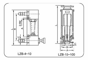

LZBÐͲ£Á§×ª×ÓÁ÷Á¿¼Æ
LZBϵÁв£Á§×ª×ÓÖ÷ÒªÓÉ×¶Ðβ£Á§¹Ü¡¢¸¡×Ó¡¢ÉÏ¡¢Ï»ù×ùºÍÖ§³ÅÁ¬½Ó×éºÏ¶ø³É¡£Í¨¾¶10mmÒÔϵÄÁ÷Á¿¼Æ£¬²ÉÓÃÈí¹ÜÁ¬½Ó,²¢¿ÉÅäÓÐÁ÷Á¿µ÷½Ú·§¡£Í¨¾¶15mmÒÔÉϵÄÁ÷Á¿²ÉÓ÷¨À¼Á¬½Ó¡£
ÐͺÅ
A
B
L
C
D
LZB-4
170
208
238
§¶12
40x35ÕýÃæ
LZB-6
LZB-10
LZB-15
§¶95
§¶65
§¶470
§¶15
4x§¶14
LZB-25
§¶115
§¶85
¦Õ§¶470
§¶25
4x§¶14
LZB-40
§¶145
§¶110
§¶570
§¶40
4x§¶18
LZB-50
§¶160
§¶125
§¶570
§¶50
4x§¶18
LZB-80
§¶185
§¶150
§¶660
§¶80
4x§¶18
LZB-100
§¶205
§¶170
§¶660
§¶100
4x§¶18
