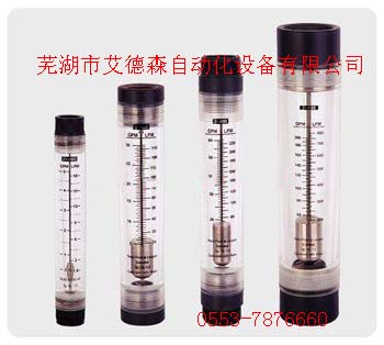

Öлª¹¤¿ØÍø ¡ú ¹¤¿Ø²úÆ· ¡ú Z-400ÐÍϵÁйܵÀÁ÷Á¿¼Æ
²úÆ·Ãû³Æ£º Z-400ÐÍϵÁйܵÀÁ÷Á¿¼Æ
ÐÍ ºÅ£º
Æ· ÅÆ£º 2614
Ïêϸ˵Ã÷£º
Z-400ÐÍϵÁйܵÀÁ÷Á¿¼Æ
¼¼Êõ²ÎÊý
ÐͺÅ
²âÁ¿·¶Î§
½Ó¿ÚÄÚÂÝÎÆ
¾«¶È%
¹¤×÷ѹÁ¦
GPM
LPM
¡À7
0.6MPa
Z-4001
0.2¡«2
1¡«7
G1/2"
Z-4002
0.5¡«5
1.8¡«18
G1/2"
Z-4003
1¡«10
4¡«36
G3/4"
Z-4004
2¡«20
10¡«70
G1"
Z-4005
5¡«30
20¡«110
G1"
Z-4006
20¡«60
80¡«220
G1 1/2 " Íâ
Z-4007
20¡«100
75¡«400
G2"
Z-4008
50¡«150
150¡«600
G2"
Z-4009
60¡«200
200¡«800
G2"

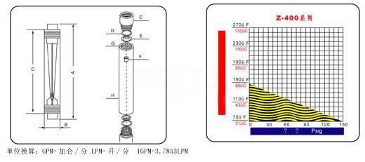

³ß´ç¼°ÍâÐÎͼ
ÐͺÅ
Z-4001
Z-4002
Z-4003
Z-4004
Z-4005
Z-4006
Z-4007
Z-4008
Z-4009
A
210
210
278
265
265
306
345
345
345
B
32
32
45
51
51
51
75
75
75
C
½Ó¿Ú(PP)»ò1Cr18Ni9Ti(304)
D
"O"ÐÍȦ(¹è½º)»ò·úÏð½º
¡ðÐÍȦ¡¡¶¡ëæÏð½º
E
Ö¹µ²È¦(ABS)
101ÄáÁú
F
¸¡×Ó1Cr18NI9TI(304)
G
µ¼¸Ë(316)
H
Ö÷Ìå(PMMA)
