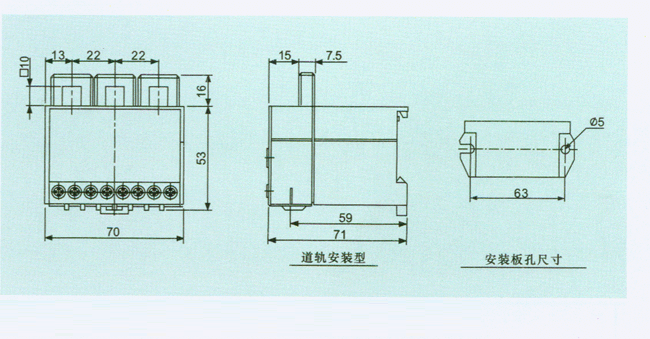

| º«¹úÈýºÍEOCR-3MS/FMS ¼¼ÊõÌõ¼þ |
| ģʽ |
3MS/FMS |
| µçÁ÷É趨·¶Î§ |
¹ýµçÁ÷(oc) |
0.1~800A |
| Ç·µçÁ÷(uc) |
"OC"É趨ֵµÄ0.5±¶ÒÔÏ |
| ½ÓµØÂ©µçÁ÷(ec) |
| ʱ¼äÉ趨 |
Æô¶¯ÑÓ³Ùʱ¼ä(dt) |
OFF~200Ãë |
| ¹ýµçÁ÷ÌøÕ¢ÑÓ³Ù(ot) |
¶¨Ê±ÏÞ:0.2~30Ãë/·´Ê±ÏÞ:1~30Ãë |
| Ç·µçÁ÷ÌøÕ¢ÑÓ³Ù(ut) |
¶¨Ê±ÏÞ0.5~30Ãë |
| ½ÓµØÌøÕ¢ÑÓ³Ù(et) |
| ¿ØÖƵçÔ´ |
220 |
85~250VAC/DC,50/60Hz |
| ¼ÌµçÆ÷Êä³ö |
OL |
2-SPST,3A/250VAC,µç×èÐÔ |
| AL(GR/SC) |
1~SPST(SC) |
| »·¾³ |
ÎÂ¶È |
´æÖü |
-30~80 ¡æ |
| ¹¤×÷ |
-20~60 ¡æ |
| ʪ¶È |
ÎÞ½á¶ʱ£¬30~85RH |
| ÏÔʾ |
7¶ÎLED |
o |
µçÁ÷·ùֵָʾ°ô |
o |
| °²×° |
35mm µ¼¹ì | | |

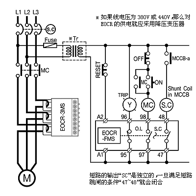

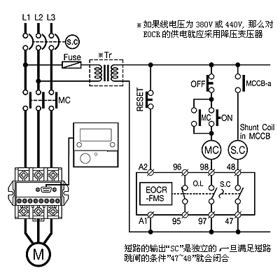

| º«¹úÈýºÍEOCR-3MS/FMS µäÐͲο¼Í¼/½ÓÏßͼ/°²×°³ß´çͼ |
