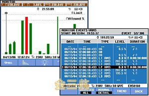

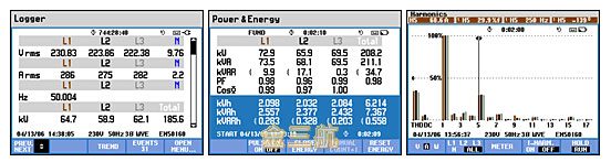

¡¤ÍêÈ«µÄÈýÏàÅÅÕϹ¤¾ß: ²âÁ¿Ã¿¸öµçÁ¦ÏµÍ³µÄʵ¼Ê²ÎÊý£ºµçѹ,µçÁ÷,ƵÂÊ,¹¦ÂÊ,¹¦ÂÊÏûºÄ(ÄÜÁ¿), ²»Æ½ºâºÍÉÁ±ä£¬Ð³²¨ºÍ¼äг²¨£¬²¶×½ÏóÖèÉýÖè½µÕâЩʼþ£¬Ë²±ä¡¢ÖжϺͿìËÙµçѹ±ä»¯
¡¤Fluke 435 ¾ßÓÐ0.1%µçѹ¾«¶È£¬Ê¹µÃÒÇÆ÷ÍêÈ«Âú×ãIEC 61000-4-31 A ¼¶±ê×¼
¡¤¼Ç¼¹¦ÄÜ:¼Ç¼ÄúËùÐèÒªµÄϸ½Ú¡£¸ø³öÓû§×Ô¶¨Òåʱ¼ä³¤¶ÈÄÚµÄMIN, MAXºÍAVGÊý¾Ý£¬¶àÖÁ100¸ö²ÎÊý£¬ËùÓÐ4Ï࣬¿Éѡƽ¾ùʱ¼äµÍÖÁ0.5 s.´æ´¢Æ÷ÄÜÂú×ã1min·Ö±æÂÊ£¬400¸ö²ÎÊý¿ÉÒԼǼ1¸öÔÂ

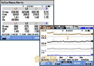

ÊäÈë ÊýÁ¿:4¸öµçѹºÍµçÁ÷£¨3Ïà+ÖÐÐԵ㣩;×î´óµçѹ:µçѹÓÐЧֵ1000 Vrms (µçѹ·åÖµ6 kV peak);×î¸ß²ÉÑùËÙ¶È:¸÷¸öͨµÀͬ²½£¬200 kS/s
µçѹ/µçÁ÷/ƵÂÊ ²âÁ¿·¶Î§:1...1000V;¾«¶È:0.1% of VnomVpeak²âÁ¿·¶Î§:1...1400V ¾«¶È:5%ofVnom;²¨ÐÎÒòÊýCF,µçѹ²âÁ¿·¶Î§:1.0...>2.8;¾«¶È:¡À5%Arms(AC + DC);²âÁ¿·¶Î§:0...20kA;¾«¶È:¡À0.5%;¡À5¸öpeak ²âÁ¿·¶Î§:0...5.5kA;¾«¶È:5%;²¨ÐÎÒòÊýCF,µçÁ÷²âÁ¿·¶Î§:1...10;¾«¶È:¡À5%Hz50Hznominal;²âÁ¿·¶Î§:42.50...57.50Hz;¾«¶È:¡À0.01Hz
