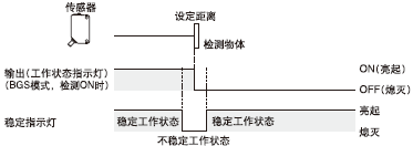

ÀûÓÃBGS/FGS¹¦ÄÜÒà¿ÉÇáËÉʵÏÖ¾«È·µÄÉ趨£¡ CX-44¡õ
´ËʱʹÓÃBGS¹¦ÄÜ£¬½«»áºÜ·½±ã
´ËʱʹÓÃFGS¹¦ÄÜ£¬½«»áºÜ·½±ã
ÎÞ±³¾°Ê± Óб³¾°Ê±
¹¤¼þÓë±³¾°ÎïÌå·ÖÀëʱ
ÎÞ±³¾°Ê±
±³¾°ÎïÌå½ôÌù¹¤¼þʱ ¹¤¼þÉÏÓйâÔó»ò°¼Í¹²»Æ½Ê±
Óб³¾°Ê±
¹ØÓÚBGS(±³¾°ÒÖÖÆ)¹¦ÄÜ ¹ØÓÚFGS(ǰ¾°ÒÖÖÆ)¹¦ÄÜ
½öÔÚÊܹâÔª¼þ(¶Ô·ÖÔª¼þ)A´¦Èë¹âʱÅжÏΪÓй¤¼þ¡£
ÓÃÓÚ¹¤¼þºÍ±³¾°ÎïÌå·ÖÀëʱ¡£
¼ì²âÔ­ÀíºÍÒÔÍùµÄ¾àÀëÉ趨·´ÉäÐÍÏàͬ¡£
²»ÔÚÊܹâÔª¼þ(¶Ô·ÖÔª¼þ)B´¦Èë¹âʱÅжÏΪÓй¤¼þ¡£
Òò´Ë£¬Òà¿É¼ì²â´ø¹âÔóµÄ¹¤¼þ¡£ÔÚ±³¾°ÎïÌå½ôÌù¹¤¼þ»ò¼ì²âÎïÌå´ø¹âÔóʱʹÓøù¦Äܽ«·Ç³£·½±ã¡£

¹¤×÷״ָ̬ʾµÆ ×° ±¸
Îȶ¨Ö¸Ê¾µÆ ÂÌÉ«LED(Îȶ¨¹¤×÷״̬ʱÁÁÆð)(×¢2)
¾àÀëµ÷½ÚÆ÷
5»Ø×ª»úеµ÷½ÚÆ÷
¼ì²âģʽ
´øÓмì²âģʽѡÔñÊäÈëÏß·µÄBGS/FGS¿Éת»»¹¦ÄÜ

CX-441¡õ ¾àÀëÉ趨·´ÉäÐÍ
¼ì²âÁìÓòÌØÐÔ
Ͷ¹â¹âÊøÌØÐÔ
É趨¾àÀë25mm É趨¾àÀë50mm Ͷ¹â¹âÊøÌØÐÔ
ÑÕÉ«£¨50*50mm»æ»­Ö½£©ºÍ¼ì²â¾àÀëÖ®¼äµÄÏ໥¹ØÏµ
²ÄÖÊ£¨50*50mm»æ»­Ö½£©ºÍ¼ì²â¾àÀëÖ®¼äµÄÏ໥¹ØÏµ
ÑÕÉ«£¨50*50mm»æ»­Ö½£©ºÍ¼ì²â¾àÀëÖ®¼äµÄÏ໥¹ØÏµ ²ÄÖÊ£¨50*50mm»æ»­Ö½£©ºÍ¼ì²â¾àÀëÖ®¼äµÄÏ໥¹ØÏµ
ÕâЩÖùÐÎͼ±íʾ¸÷¸öÎïÌåµÄ¼ì²â¾àÀëÊǵ±¾àÀëµ÷½ÚÆ÷ÔÚʹÓð×É«ÎÞ¹âÔóÖ½ÕÊʱÉ趨ÓÚ50mmºÍ25mmʱËù²âµÃµÄ¡£
ÕâЩÖùÐÎͼ±íʾ¸÷¸öÑÕÉ«µÄ¼ì²â¾àÀëÊǵ±¾àÀëµ÷½ÚÆ÷ÔÚʹÓð×ɫʱÉ趨Óë50mmºÍ25mmʱËù²âµÃµÄ¡£¼ì²â¾àÀëͬʱ»áÓÉÓÚ²ÄÖʵIJ»Í¬¶ø±ä»¯

Îȶ¨Ö¸Ê¾µÆ
¡¤ÒòΪCX-440ϵÁÐʹÓÃÒ»ÖÖ2¶Î¹âµç¶þ¼«¹Ü×÷ΪÆä½ÓÊÕÔª¼þ£¬²¢ÇÒ¸ù¾Ý¼ì²âÎïÌåËù·´ÉäµÄÏà¹ØÈë¹â½Ç¶È²îÒì½øÐмì²â£¬ËùÒÔÊä³öºÍ¹¤×÷״ָ̬ʾµÆ(³ÈÉ«)½«¸ù¾ÝÎïÌåµÄ¾àÀ빤×÷¡£ÁíÍ⣬Îȶ¨Ö¸Ê¾µÆ(ÂÌÉ«)ÏÔʾÉ趨¾àÀëµÄÓàÁ¿¡£
Îȶ¨Ö¸Ê¾µÆ
BGS / FGS¹¦ÄÜ
±¾²úÆ·×°±¸ÁËBGS/FGS¹¦ÄÜ¡£¿É¸ù¾Ý±³¾°ºÍ¼ì²âÎïÌåµÄλÖÃÑ¡ÔñBGS»òFGS¹¦ÄÜ¡£
BGS¹¦ÄÜ
µ±¼ì²âÎïÌåÔ¶Àë±³¾°Ê±£¬Ê¹Óøù¦ÄÜ¡£
BGS¹¦ÄÜ
FGS¹¦ÄÜ
ÔÚ¼ì²âÎïÌåÓë±³¾°½Ó´¥»ò¼ì²âÎïÌåÊǹâÔóÎïÌåµÈÇé¿öÏ£¬Ê¹Óøù¦ÄÜ¡£
FGS¹¦ÄÜ
