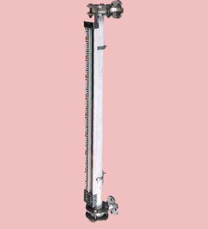

²úÆ·Ãû³Æ£º ¹©Ó¦MDZ-1J¡¢MDZ-3J/BÄÍÇ¿¸¯Ê´ÐʹŸ¡×ÓҺλ¼Æ
ÐÍ ºÅ£º MDZ-1J¡¢MDZ-3J/BÄÍÇ¿¸¯Ê´ÐÍ
¸ÃҺλ¼ÆËùÓÐÓë½éÖʽӴ¥µÄÁ㲿¼þ¾ù²ÉÓøÖËܸ´ºÏ¹Ü£¨Í¼Îª´¿PTFE¹Ü£©¡£ËùÒÔÄÜÊÊÓÃ×Ó¸÷ÖÖÇ¿¸¯Ê´½éÖʵÄҺλ²âÁ¿ºÍ¿ØÖÆ¡£
