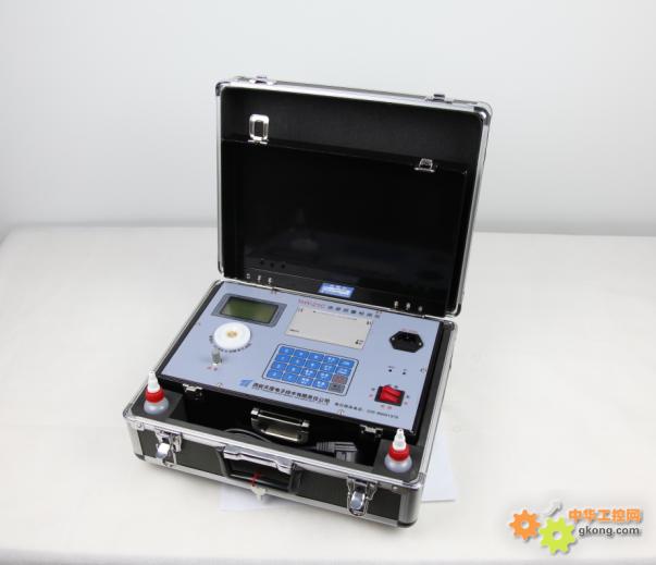

THYϵÁÐÓÍÖÐË®·Ý¼ì²âÒÇ(·ÖÎöÒÇ)ÊÇÎ÷°²Ììºñµç×Ó¼¼ÊõÓÐÏÞÔðÈι«Ë¾£¨WWW.OIL8.COM£©Ñз¢µÄ±ãЯʽÓÍÖÐË®·Ý¼ì²âÒÇ£¬¸ÃÓÍÖÐË®·Ý¼ì²âÒÇ¿ÉÒÔÏÖ³¡ÅжÏÈó»¬Ó͵ÄÎÛȾ³Ì¶È£¬ÒÔÈ·¶¨ÊÇ·ñ»»ÓÍ¡£¼ì²âйºÈó»¬ÓÍÊÇ·ñºÏ¸ñ£¬ÊÇÆóÒµ±£»¤É豸¡¢½ÚÔ¼ÄÜÔ´¼ÓÇ¿È󻬹ÜÀí¡¢ÊµÏÖ°´ÖÊ»»Ó͵ıر¸¼ì²â¹¤¾ß¡£THYϵÁÐÓÍÖÐË®·Ý¼ì²âÒÇ»ñµÃÁ˶à¸ö½±Ï¹ú¼Ò´´Ð»ù½ð¡¢È«¾ü¿Æ¼¼½ø²½¶þµÈ½±µÈ,½ØÖ¹µ½2008Äêµ×ÒÑ»ñµÃ99Ïî¹ú¼ÒרÀû¡£
ĿǰÒѹ㷺ӦÓÃÓÚ£ºº½¿Õº½Ìì¡¢ÓÍÌï¡¢¸Û¿Ú¡¢ÔËÊä¡¢¿óɽ¡¢µçÁ¦¡¢Ò±½ð¡¢»¯¹¤¡¢¹¤³Ì»úеµÈÁìÓò¡£
ÓÍÖÐË®·Ý¼ì²âÒǼ¼Êõ²ÎÊý£º
²âÁ¿·¶Î§£º[0£¬±99.9]μA
ÖØ¸´Îó²î£º≤±2%
»·¾³Î¶ȣº-15¡æ ¡« +55¡æ
Õû»ú¹¦ºÄ£º≤5W£¨²»º¬´òÓ¡£©
ÊäÈëµçѹ£º220V
Õû»úÖØÁ¿£º5Kg
³ß´ç£º 328×210×130mm
THYϵÁÐÓÍÖÐË®·Ý¼ì²âÒÇÖ÷Òª¹¦ÄÜÈçÏ£º
Ò»¡¢3·ÖÖÓÄÚ¼ì²â³öÈó»¬Ó͵ÄÎÛȾ³Ì¶È£»
¶þ¡¢3·ÖÖÓÄÚ¼ì²âÓÍÖÐ΢Á¿Ë®·Öº¬Á¿£»
Èý¡¢¿ÉÒÔÅжÏйºÓÍÆ·ÊÇ·ñºÏ¸ñ£»
ËÄ¡¢¿ÉÒÔÅжÏÈó»¬ÓÍÖÐÊÇ·ñº¬ÓÐÇáÖÊÓÍ£»
Îå¡¢¼ì²â³ö60΢Ã×ÒÔÉϵĽðÊôÄ¥Á£¡£
