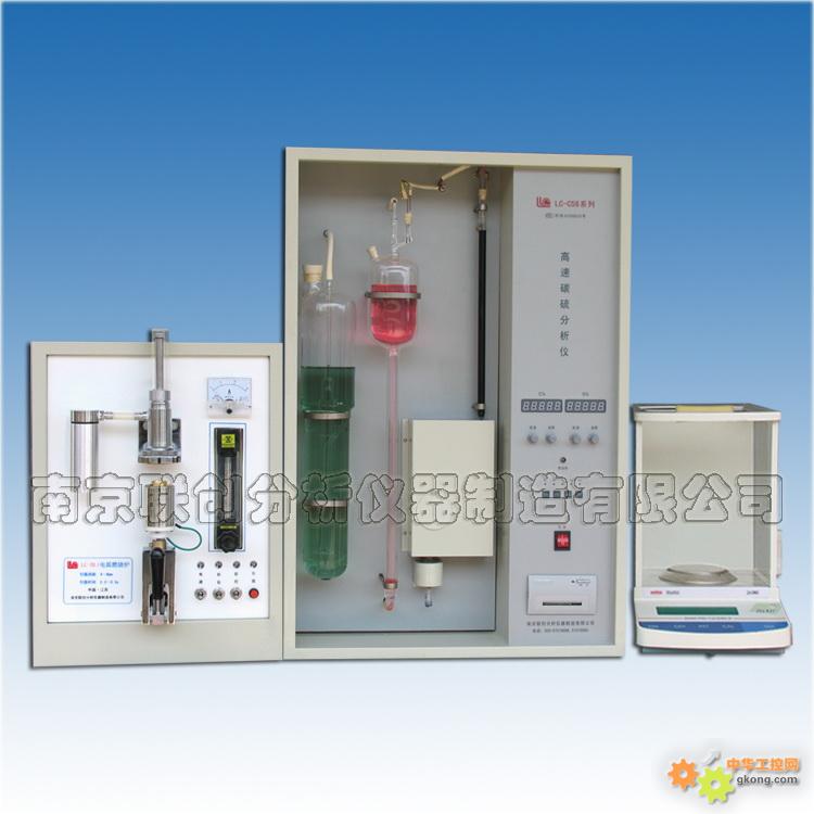

ÐÍ ºÅ£º LC-CS6E
LC-CS6EÐÍÖÇÄܸßËÙ̼Áò·ÖÎöÒÇ£¨²»¶¨Á¿³ÆÑùÈ«×Ô¶¯ÊýÏÔ´òÓ¡Ò»Ì廯¸ßËÙ̼Áò·ÖÎöÒÇ£©
Ò»¡¢Ó¦ÓÃÁìÓò
ÊÊÓÃÓÚ¸ÖÌú¡¢Ò±½ð¡¢ÖýÔì¡¢»úе¡¢»¯¹¤¡¢¿óÒµ¡¢½¨Öþ¡¢»·±£µÈÐÐÒµºÍ¸ßµÈԺУ¡¢¿ÆÑÐÔºËù¼°ÖÊÁ¿¼à¶½²¿ÃŶԸÖÌú¼°ÆäºÏ½ðµÈ²ÄÁÏÖеÄ̼ÁòÁ½ÖÖÔªËØ½øÐж¨Á¿·ÖÎö²â¶¨
¶þ¡¢Ö÷Òª¹¦ÄÜÌØµã
1¡¢Ò»Ì廯½á¹¹Éè¼Æ£¬¼õÉٹܵÀºÍµçÀµĴ«Ê䣬²âÊÔ½á¹ûÎȶ¨£¬¹ÊÕÏÂʵÍ
2¡¢ÆøÌåÈÝÁ¿·¨ÒºÌåÎüÊÕÈ«×Ô¶¯¶¨Ì¼¡¢µâÁ¿·¨È«×Ô¶¯¶¨Áò
3¡¢ÐÂÐÍ¿¹Ç§Èŵ¥Æ¬»ú¿ØÖƵç·£¬Ïû³ýÒý»¡Ç§ÈÅ£¬ÐÔÄÜÎȶ¨¿É¿¿£¬²Ù×÷¼òµ¥·½±ã
4¡¢°´¼üÉ趨¸Ö¡¢Ìú¸ßµÍ̼¶àÖÖ·½Ê½£¬×Ô¶¯±£´æ£¬±ÜÃ⿪¹ØÇл»Ôì³ÉµÄ½Ó´¥²»¿É¿¿ÏÖÏó
5¡¢²â̼²ÉÓñ¾¹«Ë¾×¨ÃÅÉè¼ÆµÄ×Ô¶¯Áãλʶ±ð¼¼Êõ£¬²â̼ÁéÃô¶ÈºÍ¾«¶È´ó´óÌá¸ß
6¡¢²âÁò²ÉÓñ¾¹«Ë¾×¨ÃÅÉè¼ÆµÄÂö³åʽ΢µÎ¶¨¼¼Êõ£¬²âÊÔ·Ö±æÂʸߣ¬½á¹û¾«ÃÜ׼ȷ
7¡¢½ø¿Ú¾«ÃÜ´«¸ÐÆ÷¼ì²âÊý¾Ý£¬²âÁ¿½á¹ûÊýÏÔÖ±¶Á£¬Î¢ÐÍ´òÓ¡»ú×Ô¶¯´òÓ¡²âÊÔ±¨¸æ
8¡¢µç×ÓÌìÆ½Áª»ú²»¶¨Á¿³ÆÑù£¬Ìá¸ß¼ì²âËÙ¶È
Èý¡¢Ö÷Òª¼¼Êõ²ÎÊý
1¡¢²âÁ¿·¶Î§£ºÌ¼£º0.010%¡«6.000% Áò£º0.003%¡«2.000%
    £¨¸Ä±ä²âÊÔÌõ¼þ£¬²âÁ¿·¶Î§¿ÉÏàÓ¦À©´ó£©
2¡¢²âÁ¿Ê±¼ä£ºÔ¼45Ã루²»º¬È¡Ñù¡¢³ÆÑùʱ¼ä£©
3¡¢²âÁ¿¾«¶È£º·ûºÏGB/T223.69-97¡¢GB/T223.68-97¹ú¼Ò±ê×¼
4¡¢µçÔ´µçѹ£º220V±10% 50Hz
5¡¢¶¯Á¦ÆøÌ壺ÑõÆø£¬Ñ¹Á¦0.02-0.04MPa
ËÄ¡¢ÒÇÆ÷µÄ×é³É
1¡¢LC-DL1Ð͵绡ȼÉÕ¯1̨
2¡¢LC-CS6EÐÍÖÇÄܸßËÙ̼Áò·ÖÎöÒÇ1̨
3¡¢µç×ÓÌìÆ½1̨
4¡¢YQY-6ÑõÆø¼õѹÆ÷£¬¹èîâ·Û£¬ÎýÁ£µÈÒÇÆ÷Åä¼þ1Ì×
¸ÃÒÇÆ÷ΪһÌ廯½á¹¹Éè¼Æ£¬È«×Ô¶¯²Ù×÷£¬Î¢»ú´¦ÀíÊý¾Ý£¬µç×ÓÌìÆ½Áª»ú²»¶¨Á¿³ÆÑù£¬¾«¶È¸ß£¬¹¦ÄÜÈ«¡£Êʺϸ÷Àà¸ÖÌú£¬»úе£¬ÖýÔìµÈÆóÒµµÄ¯ǰ·ÖÎö£¬³ÉÆ·¼ì²â£¬À´Áϼì²â£¬ÖÊÁ¿¼ìÑé¿ØÖÆµÈ²¿ÃÅ¡£ÎÒ¹«Ë¾¸ºÔðÏÖ³¡Ãâ·Ñ°²×°µ÷ÊÔÒÇÆ÷£¬ÅàѵÒÇÆ÷²Ù×÷ÈËÔ±£¬Ð­Öú³ï½¨»¯ÑéÊÒ£¬Ìṩ¶àÖֵļ¼ÊõÖ§³Ö£¬ÒÇÆ÷±£ÐÞÒ»Ä꣬ÖÕÉíάÐÞ·þÎñ£¬»¶Ó­À´µç×Éѯ¡£
