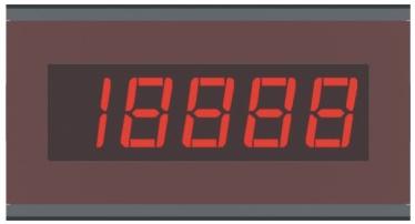

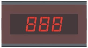

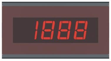

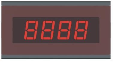

FY5130B ÈýλÊý×Ö±íÍ·
FY5135B Èýλ°ëÊý×Ö±íÍ·
FY5140B ËÄλÊý×Ö±íÍ·
FY5145B ËÄλ°ëÊý×Ö±íÍ·
