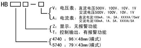

ÐÍ ºÅ£º HB5740 HB4740

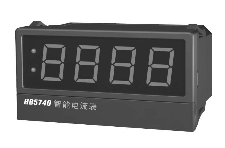

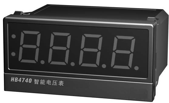

HB5740 HB4740 ÖÇÄܵçѹ±í
HB5740
HB4740

³£ÓÃÐͺţºHB5740 HB5740Z-V HB5740T-V
          HB4740 HB4740Z-V HB4740T-V

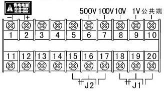

ËÄ¡¢²úÆ·½ÓÏߣº
HB5740
HB4740
