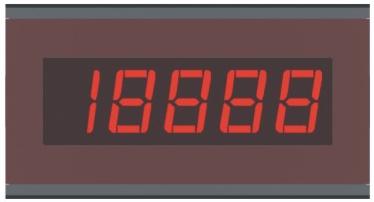

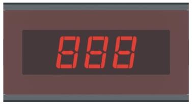

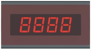

HB5130B ÈýλÊý×Ö±íÍ·
HB5135B Èýλ°ëÊý×Ö±íÍ·
HB5140B ËÄλÊý×Ö±íÍ·
HB5145B ËÄλ°ëÊý×Ö±íÍ·
