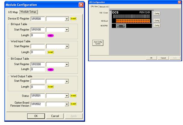

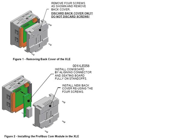

      HORNER¹«Ë¾×îпª·¢³öProfibus´ÓµÄͨѶģ¿é£¨HE-XPBS£©£¬ËùÓÐXLϵÁпØÖÆÆ÷¾ù¿É°²×°¡£¿ÉÒÔʹXLϵÁпØÖÆÆ÷·½±ãµÄÓëProfibusÖ÷½øÐÐͨѶ£¬ÊµÏÖÊý¾Ý½»»»¡£°²×°·½±ã£¬ÈÔ±£³ÖXLϵÁпØÖÆÆ÷µÄÕûÌ廯£¬ÅäÖÃҲʮ·Ö¼òµ¥¡£

DPV0
Hardware Interface Ó²¼þ·½Ê½
RS-485
Power µçÔ´
100mA at 5V
Transmission Rate ´«ÊäËÙÂÊ
9.6K ¨C 12M bits/second
Data Access Êý¾Ý·ÃÎÊ
Cyclic Polling Ñ­»·¶ÁÈ¡
Device Identity É豸ʶ±ð
ÿ¸öÉ豸ÓÐΨһµÄIDºÅ
Ö§³ÖProfibus DPµÄOCS
ËùÓÐXLϵÁпØÖÆÆ÷XLe, XLT, XL6£¬XL6e
