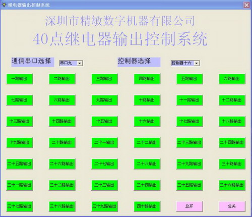

5¡¢Ö§³Öͨ¹ýµçÄÔÉÏλ»ú½çÃæÊµÊ±¼à¿Ø40·ÒÔÉ϶ą̀×éÍø¿ØÖƵĶà·Êä³ö£»
6¡¢Ê¹ÓÃPC´®¿Ú¿ØÖÆ£¬ÇáËÉʵÏֶ෵ƹ⡢µçÔ´¡¢ÒôƵ»òÊÓÆµ¿ª¹Ø¡¢ÃŽû¿ª¹ØµÈÊý×ÖÁ¿ÐźŵÄʵʱ״̬¼à²âºÍ¿ØÖÆ£¡

2¡¢ÉÏλ»ú£¨PC»ú»òÖ÷PLC£©Í¨¹ý´®¿ÚÁ¬½Óµ½±¾¿ØÖÆÆ÷ºó£¬Ïò¿ØÖÆÆ÷·¢ËÍÒ»´®ASCII´úÂëÖ¸Áî¼´¿É¿ØÖÆÄ³¸ö£¨»òÈ«²¿£©¼ÌµçÆ÷´ò¿ª»ò¹Ø±Õ£¬ÍêÈ«²»±ØÒª¿¼ÂǼ̵çÆ÷µÄÓ²¼þµç·ÉÏÑ¡Ôñ¡¢Çý¶¯µÈÎÊÌâ¡£±ÈÈ磬´®¿ÚÊäÈëO(002, 1)ÔòµÚ2ºÅ¼ÌµçÆ÷ͨµçÎüºÏ£»´®¿ÚÊäÈë¡°O(012, 0)¡±£¬ÔòµÚ12ºÅ¼ÌµçÆ÷ʧµç¶Ï¿ª¡£
