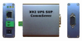

²úÆ·Ãû³Æ£º UPS ÔöÇ¿ÐÍͨѶЭÒéת»»Æ÷
ÐÍ ºÅ£º X92
X92   UPS ÔöÇ¿ÐÍͨѶ·þÎñÆ÷

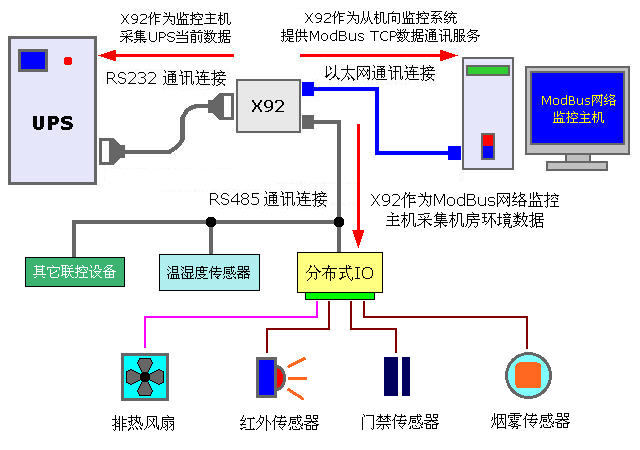

    X92 UPS ͨѶ·þÎñÆ÷ÊÇÕë¶ÔUPS½ÓÈëµ½ModBus×ÜÏߺÍÒÔÌ«Íø¼à¿ØÍøÂç¶øÉè¼ÆµÄ£¬X92ͨ¹ýUPSÌṩµÄRS232ͨѶ½Ó¿Ú¶ÔUPS½øÐÐ¼à¿Ø£¬°Ñ²É¼¯µ½µÄÊý¾Ý£¨ÈçÊäÈëµçѹ£¬Êä³ö¸ºÔصȲÎÊý£©±£´æµ½Êý¾Ý½»»»ÖÐÐÄ£¬ÕâÑù¼à¿ØÖ÷»ú¾Í¿ÉÒÔͨ¹ýX92 RS485ͨѶ¿ÚÌṩµÄModBus RTU/ASCII·þÎñ£¬»òÕßÒÔÌ«Íø½Ó¿ÚÌṩµÄModBus TCP·þÎñ£¬ÊµÏÖ´ÓModBus ×ÜÏß»òÕß¾ÖÓòÍøÉ϶ÔUPS½øÐÐ¼à¿Ø¡£
 Ê¹ÓÃͼ½â
