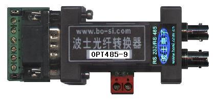

Ò»¡¢ÓÃ;
²¨Ê˵ç×ÓµÄOPT232TL£¨¶àÄ££©ÐÍRS-232/TTL/¹âÏËת»»Æ÷ÓÃÓÚʵÏÖRS-232µçƽ¡¢TTLµçƽµÄ¹âÏË´«Êä¡¢ÊÇÊÀ½çÉÏ×îСµÄ´®¿Ú/¹âÏËת»»Æ÷¡£OPT232TL¾ßÓÐRS-232½Ó¿ÚÒÔ¼°TTL½ÓÏß¶Ë×Ó£¬µçÔ´½ÓÏß¶Ë×Ó£¬¿ÉÒÔÔÚ¿Á¿ÌµÄÌõ¼þÏÂʵÏÖ¹âÏËͨÐÅ¡£
¶þ¡¢Ó²¼þ°²×°
OPT232TLÐÍRS-232/TTL/¹âÏËת»»Æ÷£¨¶àÄ££©µÄÍâÐÎΪDB-9/DB-9ת½ÓºÐ´óС£¬ÆäÖÐDB-9(¿××ù)Ò»¶ËΪRS-232µçƽ£¬ÁíÍâÒ»¶ËΪһ¶ÔST¹âÏ˽ÓÍ·¡£ÉϲàÃæÓÐTTLµçƽµÄ½ÓÏß¶Ë×Ó¡¢Ï²àÃæÓÐ5VµçÔ´½ÓÏß¶Ë×Ó¡£
OPT232TLµÄDB-9¿×¶Ë¿ÉÒÔÖ±½ÓÍâ²åPC»úµÄDB-9ÕëRS-232¿Ú£¨Õë×ù£©¡¢Ö»Óõ½RXD-2¡¢TXD-3¡¢GND-5Èý¸öÐźÅÏß¡£TTLµçƽµÄÒý½ÅλÓÚ²úÆ·ÉϲàÃæ£¬ÈçÏÂÃæµÄ²úƷͼËùʾ¡£TTLÒý½Å¹²3¸ö½ÓÏß¶Ë×Ó£¬ÖмäÒ»¸öΪGNDµØÏߣ¬×óÓÒÁ½²à·Ö±ðΪÊÕ·¢ÐźÅÏߣ¬×¢ÒâͼʾµÄTTLÐźŵĽÓÊÕ¡¢·¢ËÍÁ÷Ïò¡£
OPT232TLͨ¹ýÌøÏßÉèÖÃÀ´Ñ¡ÔñÊǽÓRS-232»¹ÊÇTTL¡£ÌøÏßλÓÚTTL½ÓÏß¶Ë×ÓµÄÅԱߡ£½ÓRS-232¿ÚÊ±ÌøÏß¿¿RS-232¿Ú²à¶Ì½Ó¡£½ÓTTLÊ±ÌøÏß¿¿¹âÏ˲à¶Ì½Ó¡£
OPTϵÁйâÏËת»»Æ÷ʹÓÃʱ·¢ËÍÆ÷STͷͨ¹ý¹âÏ˽ӶԷ½µÄ½ÓÊÕÆ÷STÍ·¡£Íâ½Ó5VµçÔ´ÒªÇó4.5 Vµ½5.5V£¬Ëæ²úÆ·ÅäÌ×Ãâ·ÑÌṩµçÔ´£¬²úÆ·¹¦ºÄСÓÚ100mA¡£
Èý¡¢ÐÔÄÜÌØµã
²¨Ê˵ç×ÓµÄOPT232TL¹âÏËת»»Æ÷ËÙÂÊ0¡ª115.2Kbps¡£¾ùÎÞÐèÈκÎÈí¼þ³õʼ»¯ÉèÖã¡È·±£ÊʺÏËùÓÐÈí¼þ¼°´®¿Ú¹âÏ˽ӿÚ!
¹âÏË½Ó¿Ú ST£¨¿ÉÑ¡FC¡¢SC£© µçÆø½Ó¿Ú DB-9¡¢DB-25
´«Êä½éÖÊ Ë«¶àÄ£¹âÏË ³ß´ç¼°
ÖØÁ¿ DB-9/9ת½ÓÍ·´óС¡¢70¿Ë
ͨÐÅ
·½Ê½ ±ê×¼RS-232µçƽ¡¢TTLµçƽ 17£ª33£ª77mm¡¢
ËÙÂÊ£º0¡ª115.2Kbps ´«Êä¾àÀë 4Km£¨¶àÄ££©
¹â²¨³¤ 820nm£¨¶àÄ££© ÊÊÓùâÏË 50/125¡¢62.5/125¡¢100/140um
¹«Ë¾µç»° 027-51518047 62425625 ´«Õæ 027-51518048
