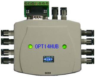

  OPT12HUB    1·´®¿Ú¹âÏËÀ©2·¹âÏ˼¯Ïßת»»Æ÷  ÊʺÏÐÇÐιâÏË×éÍø¡¢5V¹©µç
  OPT14HUB      1·´®¿Ú¹âÏËÀ©4·¹âÏ˼¯Ïßת»»Æ÷  ÊʺÏÐÇÐιâÏË×éÍø¡¢5V¹©µç

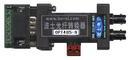

 OPT485-9  Î¢ÐÍͨÓÃRS-232/RS-485/RS-422/¹âÏËת»»Æ÷   5V¹©µç£¬DB-9/DB-9ÍâÐÎ
