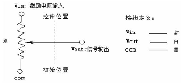

Ò»¡¢¹¤×÷Ô­Àí
   YHLÐÍÎ»ÒÆ´«¸ÐÆ÷½«»úÐµÎ»ÒÆÁ¿×ª»»³É¿É¼ÆÁ¿µÄ¡¢³ÉÏßÐÔ±È
ÀýµÄµçÐźš£±»²âÎïÌå²úÉúÎ»ÒÆÊ±£¬À­¶¯ÓëÆäÏàÁ¬½ÓµÄ¸ÖÉþ£¬
¸ÖÉþ´ø¶¯´«¸ÐÆ÷´«¶¯»ú¹¹ºÍ´«¸ÐÔª¼þͬ²½×ª¶¯£»µ±Î»ÒÆ·´ÏòÒÆ
¶¯Ê±£¬´«¸ÐÆ÷ÄÚ²¿µÄµ¯»É»ØÐý×°Öý«×Ô¶¯ÊÕ»ØÉþË÷£¬²¢ÔÚÉþË÷
ÉìÊÕ¹ý³ÌÖб£³ÖÆäÕÅÁ¦²»±ä£¬´Ó¶øÊä³öÒ»¸öÓëÉþË÷ÒÆ¶¯Á¿³ÉÕý
±ÈÀýµÄµçÐźš£
±¾Æ·ÊÇ»ùÓÚÕ𶯻·¾³Éè¼Æ°²×°Ê¹ÓõÄСÐÍ£¬¹¤Òµ¼¶+£¨×Ô¶¯ÅÅ
Ïߣ©µÄ²úÆ·¡£
¶þ¡¢Ö÷ÒªÌØµã
   YHLϵÁд«¸ÐÆ÷µÄÉè¼Æ¾«ÃܺÏÀí£¬²ÉÓø߾«ÃÜ´«¸ÐÔª¼þ£¬´«
¸ÐÆ÷¾ßÓÐÌå»ýС£¬Ê¹Ó÷½±ã£¬ÃÜ·âÐԺ㬲âÁ¿¾«¶È¸ß£¬Î¶ÈÎó
²îС£¬ÊÙÃü³¤µÈÓŵ㡣
¸Ã´«¸ÐÆ÷²»½öÊÊÒËÓÚ×÷Ö±ÏßÔ˶¯µÄ»úеÎïÌåÎ»ÒÆ²âÁ¿£¬¸üÊÊÒË
ÓÚ»úеÎïÌå×÷ÇúÏßÔ˶¯µÄÎ»ÒÆ²âÁ¿¡£
Èý¡¢Ö÷Òª¼¼ÊõÖ¸±ê
1¡¢Î»ÒÆÓÐЧ²âÁ¿·¶Î§£º100¡¢200¡¢500¡¢700¡¢1000¡¢
1500¡¢2000¡¢5000¡¢8000mmµÈ¶àÖÖÁ¿³Ì¡£
2¡¢ÊäÈ뼤Àøµçѹ£º+5VDC£»+12VDC£»+24VDCµÈ
3¡¢ÐźÅÊä³ö£ºµçλ¼Æ£¬µçѹ£¬µçÁ÷, ±àÂëÆ÷Âö³å¡¢¼ÆËã»ú½Ó¿Ú
µÈ
4¡¢ÏßÐÔ¾«¶È£º200mmÓÅÓÚ±0.5%£¬500mmÒÔÉÏÓÅÓÚ±
0.28%£¨Îó²î×î´óµã£¬·Ç×ۺϾ«¶È£©
5¡¢¹¤×÷ζȣº-15º-75ºC
6¡¢ÖÆÔì²ÄÁÏ£ººÏ½ð½ðÊô
7¡¢ÉþË÷²ÄÁÏ£º¸ßÈáÐÔ½ðÊôо˿
8¡¢µçÀ³¤¶È£º1Ã×
