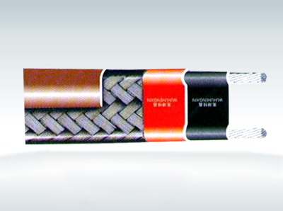

²úÆ·Ãû³Æ£º ¸ßÎÂϵÁеçÈÈ´ø
ÐÍ ºÅ£º GWK-J
¸ßÎÂϵÁеÄÏêϸ×ÊÁÏ£º
                                     ¸ßÎÂϵÁÐ
²úÆ·ÐÅÏ¢£º
Ò» ²úÆ·ÐͺÅ
ͬϵÁвúÆ·£¨KTV¡¢GXW¡¢GKW¡¢ZKWG¡¢GBW¡¢DZLµÈ£©£º
²úÆ·Ãû³Æ
ÐͺŹæ¸ñ
¹¦ÂÊ£¨W/m 10¡æ£©
¹¤×÷µçѹ£¨V£©
×î´óʹÓó¤¶È£¨m£©
£¨×èȼ£©¸ßλù±¾ÐÍ
£¨ZR£©GWK-J
45¡¢55¡¢65¡¢75
220~600
100
£¨×èȼ£©¸ßηÀ»¤ÐÍ
£¨ZR£©GWK-F
45¡¢55¡¢65¡¢75
220~600
100
£¨×èȼ£©¸ßÎÂÆÁ±ÎÐÍ
£¨ZR£©GWK-P
45¡¢55¡¢65¡¢75
220~600
100
£¨×èȼ£©¸ßÎÂÆÁ±Î·À»¤ÐÍ
£¨ZR£©GWK-PF
45¡¢55¡¢65¡¢75
220~600
100
£¨×èȼ£©¸ßÎÂÆÁ±Î·À¸¯ÐÍ
£¨ZR£©GWK-PF2
45¡¢55¡¢65¡¢75
220~600
100
ÀýÈ磺45GWK2-J  ¼´:¸ßλù±¾ÐÍ£¬10¡æÊ±Ã¿Ã×Êä³ö¹¦ÂÊ45W£¬¹¤×÷µçѹ220V¡£
      ZR65GWK3-PF  ¼´:×èȼ¸ßÎÂÆÁ±Î·À»¤ÐÍ£¬10¡æÊ±Ã¿Ã×Êä³ö¹¦ÂÊ65W£¬¹¤×÷µçѹ380V£¬¾ßÓÐ×èȼ¡¢·À±¬¡¢·À»¤ÐÔÄÜ¡£
¶þ ¼¼ÊõÖ¸±ê£º
   1¡¢Î¶ȷ¶Î§£º
               ×î¸ß¹¤×÷ζÈ130¡À5¡æ;
               ×î¸ß±íÃæÎ¶È150¡æ£»
               ×î¸ß³ÐÊÜζȣº¸ÄÁ¼ÐÔ¾ÛÏ©Ìþ105¡æ¡¢×èȼ¾ÛÏ©Ìþ135¡æ¡¢º¬·ú¾ÛÏ©Ìþ180¡æ¡¢È«·ú²ÄÁÏ205¡æ
   2¡¢Ê©¹¤Î¶ȣº×îµÍ-40¡æ,×î¼ÑÊ©¹¤Î¶ÈΪ0¡æÒÔÉÏ
   3¡¢ÈÈÎȶ¨ÐÔ£ºÍ¨¶Ï¸÷1000´Î£¬Á¬Ðø30Ì죬µçÀ·¢ÈÈÁ¿Î¬³ÖÔÚ90%ÒÔÉÏ¡£
   4¡¢ÍäÇú°ë¾¶£º20¡æÊÒÎÂʱΪ12.7mm
               -30¡æµÍÎÂʱΪ35.0mm
   5¡¢¾øÔµ×裺µçÀ³¤¶È100m£¬ÊÒÎÂ20¡æÊ±ÓÃ1000VDCÔÚÆÁ±Î²ãÓëµ¼µçÏßо֮¼äÒ¡ÊÔ1·ÖÖÓ£¬¾øÔµµç×è×îСֵΪ20M¦¸¡£
   6¡¢¹¤×÷µçѹ£º220¡¢380¡¢600·üÌØµÈ£¬½»Ö±Á÷Á½Ó㬵͵çѹ²úÆ·²»µÃÔڸߵçѹÌõ¼þÏÂÓ¦Óá£
Ó¦Ó÷¶Î§£º
¹ã·ºÓ¦ÓÃÓÚʯÓÍ¡¢»¯¹¤¡¢¸ÖÌú¡¢µçÁ¦µÈÐÐÒµµÄ¹¤ÒÕ¹ÜÏß¡¢´¢¹Þ°éÈȱ£Î¼°·À¶³±£Î£¬Æä½éÖÊά³Öζȷ¶Î§Îª0¡«135¡æ
    »ù±¾Ð͵çÈÈ´øÒ»°ãÓÃÓÚÎÞ·À±¬¡¢ÎÞ·À¸¯ÒªÇó£¬ÇÒ»·¾³Êª¶È²»´óµÄ³¡Ëù£»
    ·À»¤Ð͵çÈÈ´øÒ»°ãÓÃÓÚÎÞ·À±¬¡¢ÎÞ·À¸¯ÒªÇ󣬵«»·¾³Êª¶È½Ï´óµÄ³¡Ëù£»
    ·À±¬Ð͵çÈÈ´øÒ»°ãÓÃÓÚÓзÀ±¬¡¢ÎÞ·À¸¯ÒªÇ󣬻·¾³Êª¶È²»´óµÄ³¡Ëù£»
    ·À±¬·À»¤Ð͵çÈÈ´øÒ»°ãÓÃÓÚÓзÀ±¬¡¢ÎÞ·À¸¯ÒªÇ󣬻·¾³Êª¶È½Ï´óµÄ³¡Ëù£»
    ·À±¬·À¸¯Ð͵çÈÈ´øÒ»°ãÓÃÓÚÓзÀ±¬¡¢ÓзÀ¸¯ÒªÇ󣬻·¾³Êª¶È½Ï´óµÄ³¡Ëù
